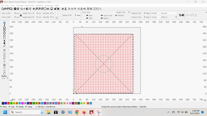

Which mode do you use to send the 350x350 pattern? Absolute coordinates? Show a screenshot of the full LightBurn window.

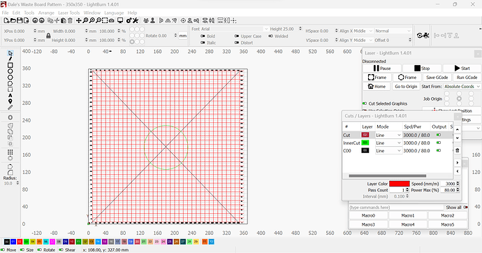

In case you need my settings.
Hi Melvin,
Please disregard the first screen shot of my grid. I was playing around with work space sizes per your first response, and thought it might work; it didn’t Attached is the way I had it, 368 X 358. Still won’t frame.
Thanks for your help!
Dale

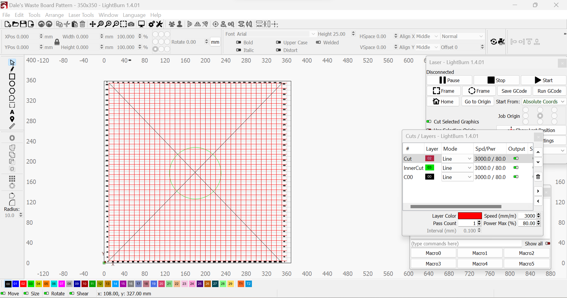

There are some issues:
  • you set the start to absolute coordinates, but your grid doesn’t start at 0,0 (you have the text as well that is outside your grid)
  • what’t the size of the grid if you select everything (ctrl+a)? It’s still smaller than the workspace size?
I recommend:
  • move the text inside the grid and not outside
  • set the start from setting to “current position”
  • set the job origin to bottom left
  • select the grid and also enable “use selection origin” beneath “cut selected graphics”
  • home
  • then send the job if you made sure that it completely fits into the area (you should have selected all that is available and see the size in the top menu bar)

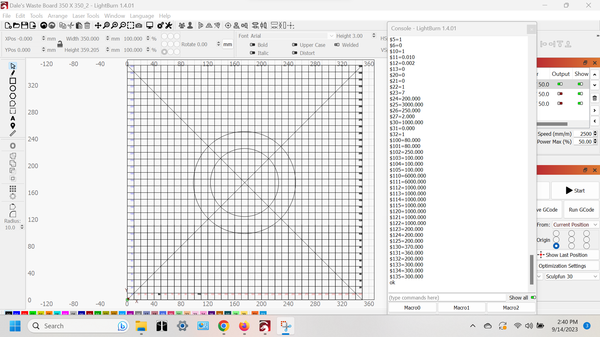

Send $$ in the console window and show all displayed settings from $1 to $1xx. Maybe there’s something else in the settings.
I’m redoing the whole thing. I’ll let you know.
Thanks!
Dale
Actually, it’s basically working. It’s more than a little frustrating that a manufacturer would advertise a machine at 410X400, and find out later that the actual workspace is significantly less! I don’t know if others besides Sculpfun do this, but I’m guessing they do. Same as advertising input wattage instead of the laser’s actual output.

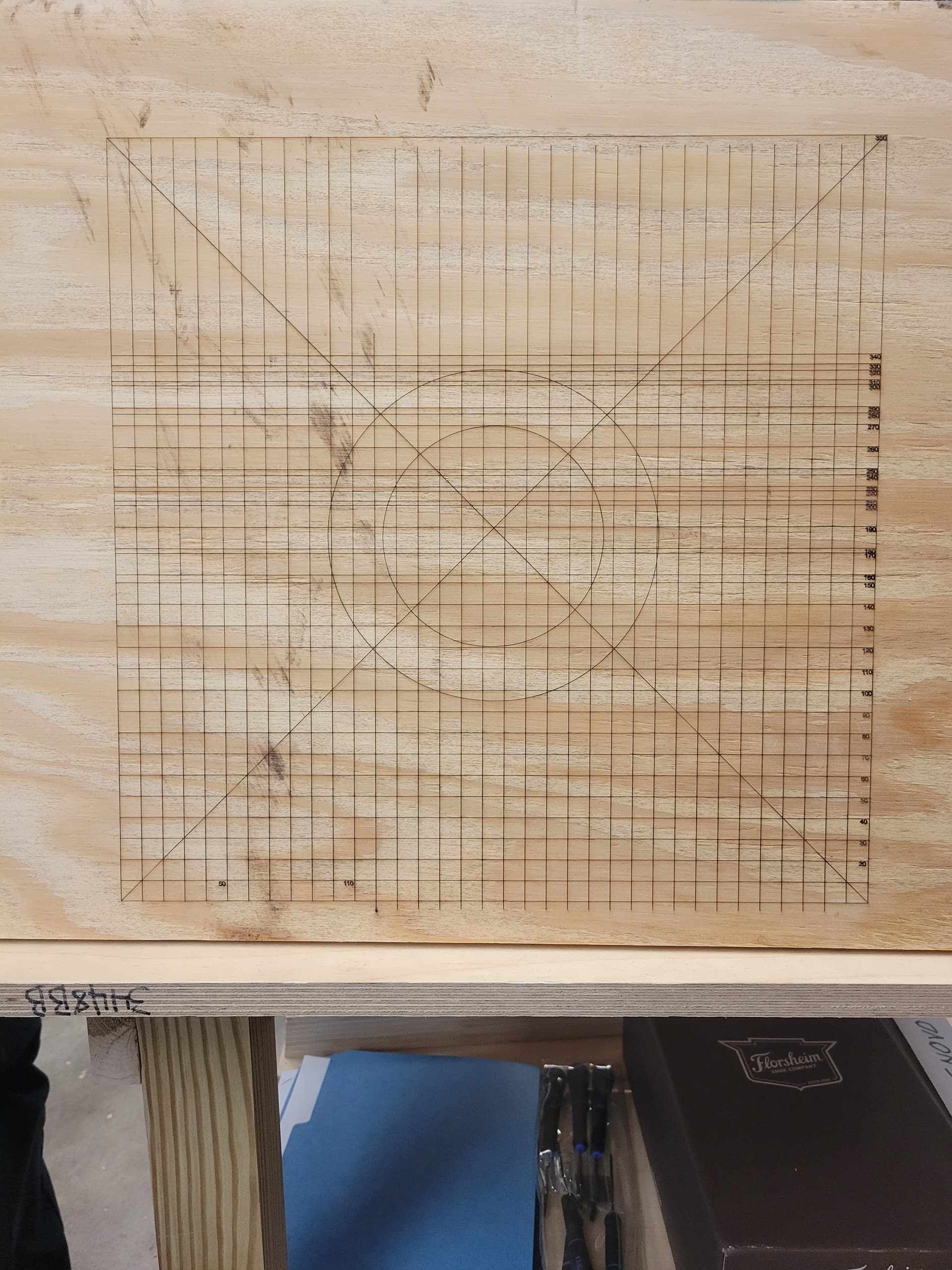

I started to run the project and all seemed fine. Then the X lines started to etch and the lines were being made in less than 10 mm spaces. Big mistake! While I did look at the preview, I didn’t play it. I learned a lesson the hard way. About a third of the way through the X lines, I was looking at my laptop screen, and the lines looked like a shadow behind the lines I drew. Actually, I drew 1 line each for X and Y then used the array tool to put in 35 rows and columns. But what I saw once I zoomed way in was the 10 mm lines on the Lightburn screen and the lines from the array tool were not exactly on top of each other. I looked at the small height window in the toolbar and after the first 8-10 X lines, the height went from 0 to .406. unbelievable! I checked the spacings in the array settings and it said 10mm. I learned a long time ago in woodworking, you measure twice and cut once. I should have known better.
I did play the preview after making the X height adjustments, and it looks good. Not a big deal, I just need to flip the waste board and do it again.

I’m back! At least I’m getting smarter, I tried to engrave the grid again, this time on a piece of scrap. But, as you can see, it did not engrave as previewed. I went back to my design layout, zoomed way in, and selected each individual row for location errors, that is to make sure they matched the Lightburn screen grid. For whatever reason, and I’m hoping you can tell me, the Y axis grid lines are not etching at 10mm spacing. Attached is a screen shot of the grid with Console $$. I also attached a photo of the project.
Also, while I have you. I decided to add text to the right Y axis after I completed the initial layout. I can’t figure out to assign to an existing layer.
Your firmware settings look fine. It’s not a configuration issue.
It looks like you have a mechanical problem, the y-axis is not running as it should. Follow the recommendations on this page to check for errors:
First, check the little grub screws securing the pulleys and rod of the y-axis drive mechanism. It seems there is a major production issue with the Sculpfun devices that those are not fixed properly (reported by many users).
I’d be curious to compare the preview to see what order it ran those in. Looks like you were going good and it lost some steps somewhere. Maybe something loose, maybe a crash, maybe an acceleration that’s right on the edge…

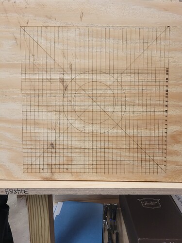

Good to go. I rechecked belt tensions. While the carriage did seem to travel smoothly when tilting the machine, it still took several tweaks to get it just right.

I checked all the grub screws again and they were all tight. The belts were centered appropriately, so that left the belts. Since I had no "errors on the X axis I left it alone, I looked to the Y belts. When tilted at 45 degrees, the carriage seemed to slide smoothly. But, I started to tweak the. First a little tighter, still slid but slower, ran a test and had to loosen a bit. Ran another test, band I found the sweet spot.
My grid came out perfect, thanks to all of your help!
