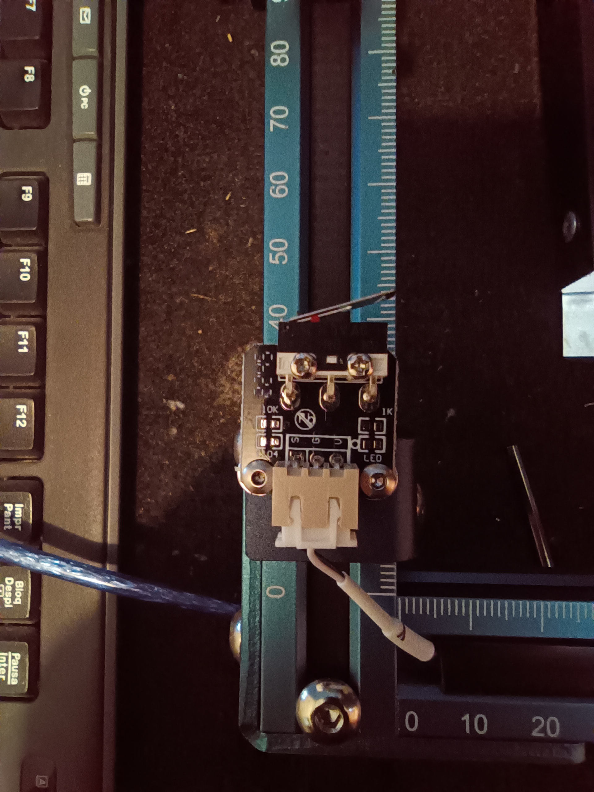

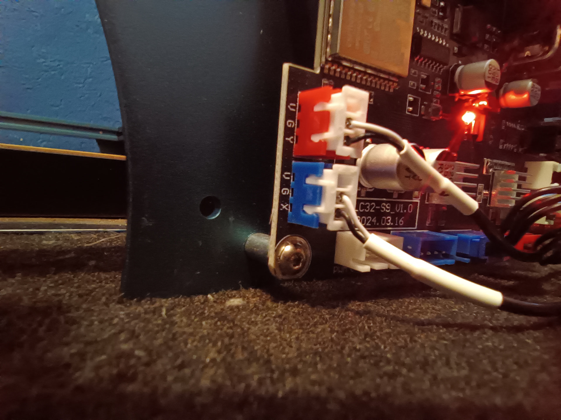

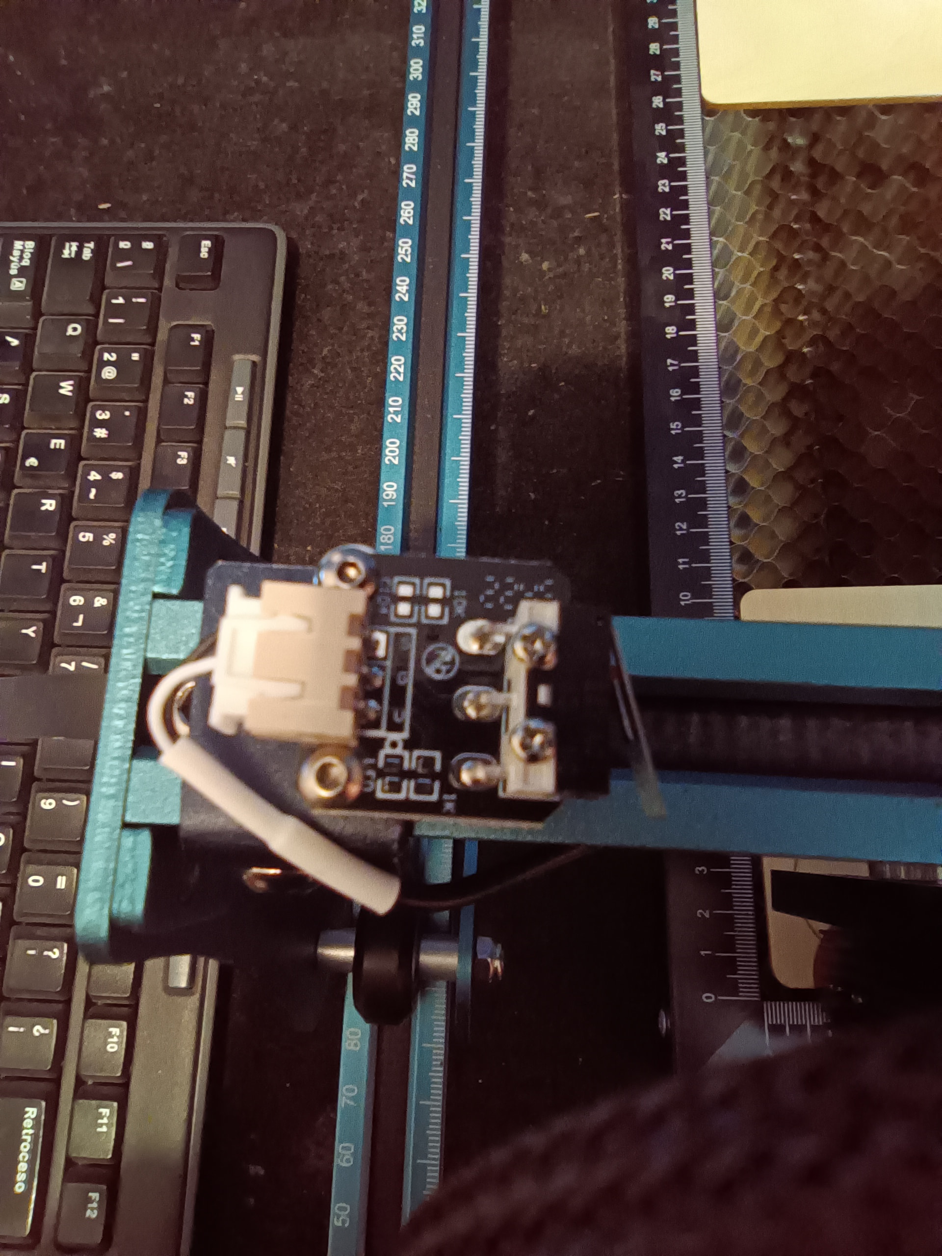

Ok, then they seem to work fine, electrically. The next test would be to check if they are wired correctly. You might have switched x and y, which will lead to a similar behavior. Some mainboards also had incorrect prints on them.
Activate and hold the limit switch on the front-left of the frame. Then send the ? command in console. Check the output “Pn:” it should list “Pn:Y”. Is this the case?
Hi. I AM in My office.
They have labels and i check.
What command i use to check if they are the corect
Tnx
The top picture is X, the middle one Y.
The command is the question mark (“?”). Send it in the console window while pressing one of the switches and check.
<Alarm|WPos:385.000,385.000,0.000|FS:0,0|Pn:XY>
Which did you press? Both? Press only one.
i pres only 1 the x
Then your y switch is faulty. It’s also activated. The message shows both switches active. How does it look like when no switch is pressed?

That confirms the problem with the Y limit switch, as Melvin suspected.
Enter the ? command again without pressing any of the switches, and tell us the output on the console.

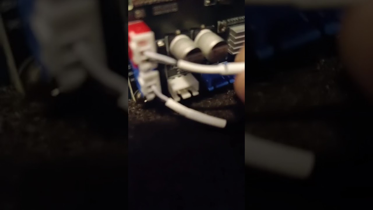

I think this video shows that your switches are swapped. Once the front switch is hit, the head stops (so the X axis was triggered instead of y). Since now the other switch won’t be hit anymore, the laser tries to go further on the y axis.
Swap the cables on the mainboard and try again.

I think Melvin has already found the solution. You just need to implement it.
HI
It seems to be fixed now. So all this time it was either mislabeled or due to the machine’s design.
I contacted support directly via email. They were very helpful. It seems to be working now. I’m going to run some tests to properly configure the CAM500 and ensure my home is always available.
