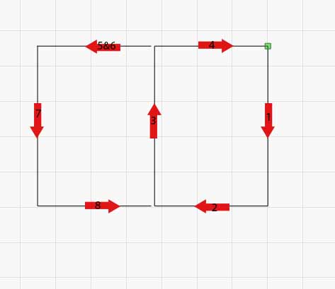

cut order

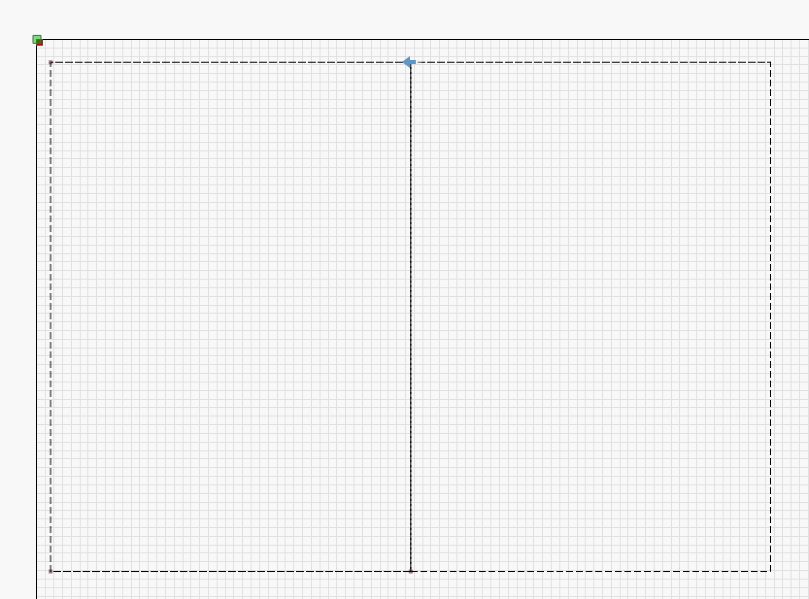

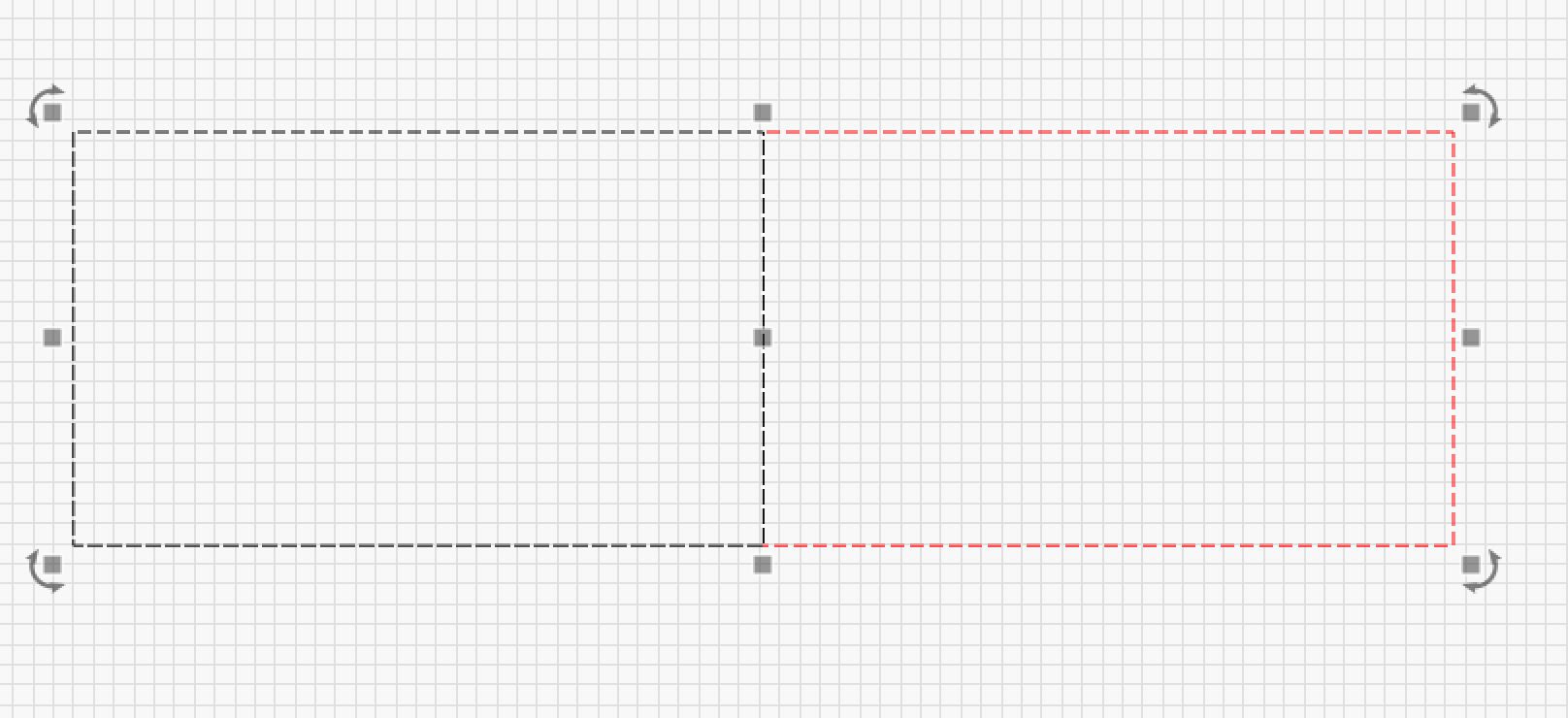

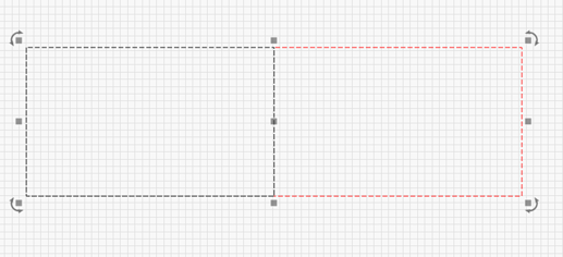

I was trying to cut two equal rectangles. I duplicated the first rectangle, put the 2nd one side by side with the first, just touching, then removed the line in the middle which was duplicated. (I show them slightly separated in the diagram for clarity.) Cuts 1-5 were as expected, but then the head went to the right and repeated cut 5, then did cuts 7 & 8. I have repeated this with different sizes and both 10.0.04 and 10.0.06. The preview does indeed show cut 5 being repeated. What’s happening here???

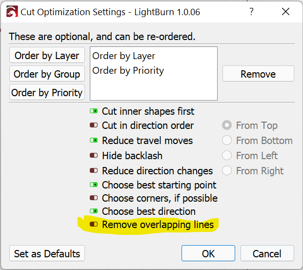

Indirectly related to your question I wanted to make you aware of an alternative way of removing redundant lines in cases like this. There’s a specific setting in Optimization settings called “Remove overlapping lines” that’s intended to avoid double-cutting overlapping lines.
Might be useful for future reference.
Didn’t remember that one. Thanks!

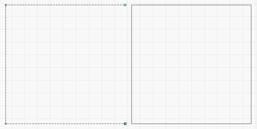

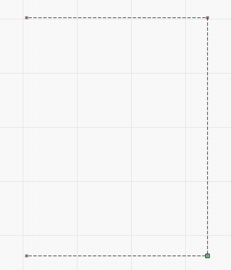

Hmm… well, I think I see the problem but not sure how to fix it. If you look at the partial square in node edit mode you can see a green box in one of the internal corners so I think that’s interpreted as the “start” of the line. So it circles back to burn the line segment again. I’ll be curious what @Rick comes back with.

I’m not sure how it occurs but the green square that indicates an end node isn’t located at one of the ends of the line segments.
I’ve thought of a workaround but it’s not elegant.

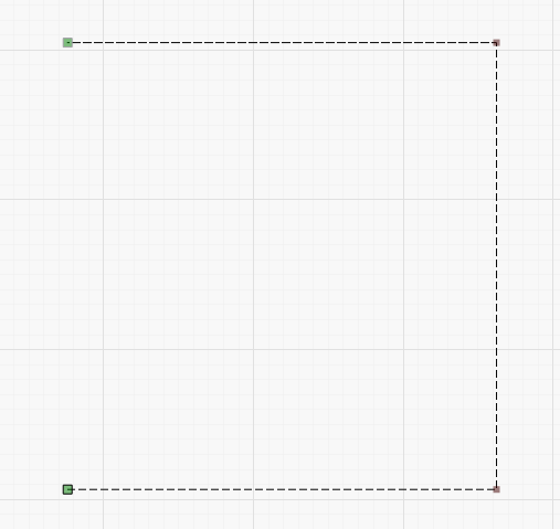

  1. Select the partial square
  2. Arrange->Break apart
  3. Select all segments of partial square
  4. Edit->Auto-join selected shapes
This seems to force LightBurn to reevalute the segment relationships and corrects the node issue.

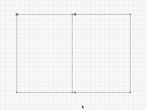

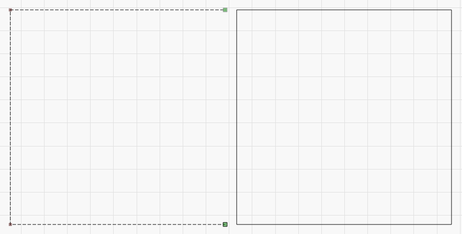

I drew it all in Lightburn. First drew one rectangle, duplicated it, dragged second one over alongside first, converted to path, broke two nodes apart, and deleted the duplicated line.
If I follow those steps, here is what I see produces. Note there are two green nodes, one at either end of that shape path. Looking at yours, there is only one. I am looking into how your shape produced like that. :slight_smile:

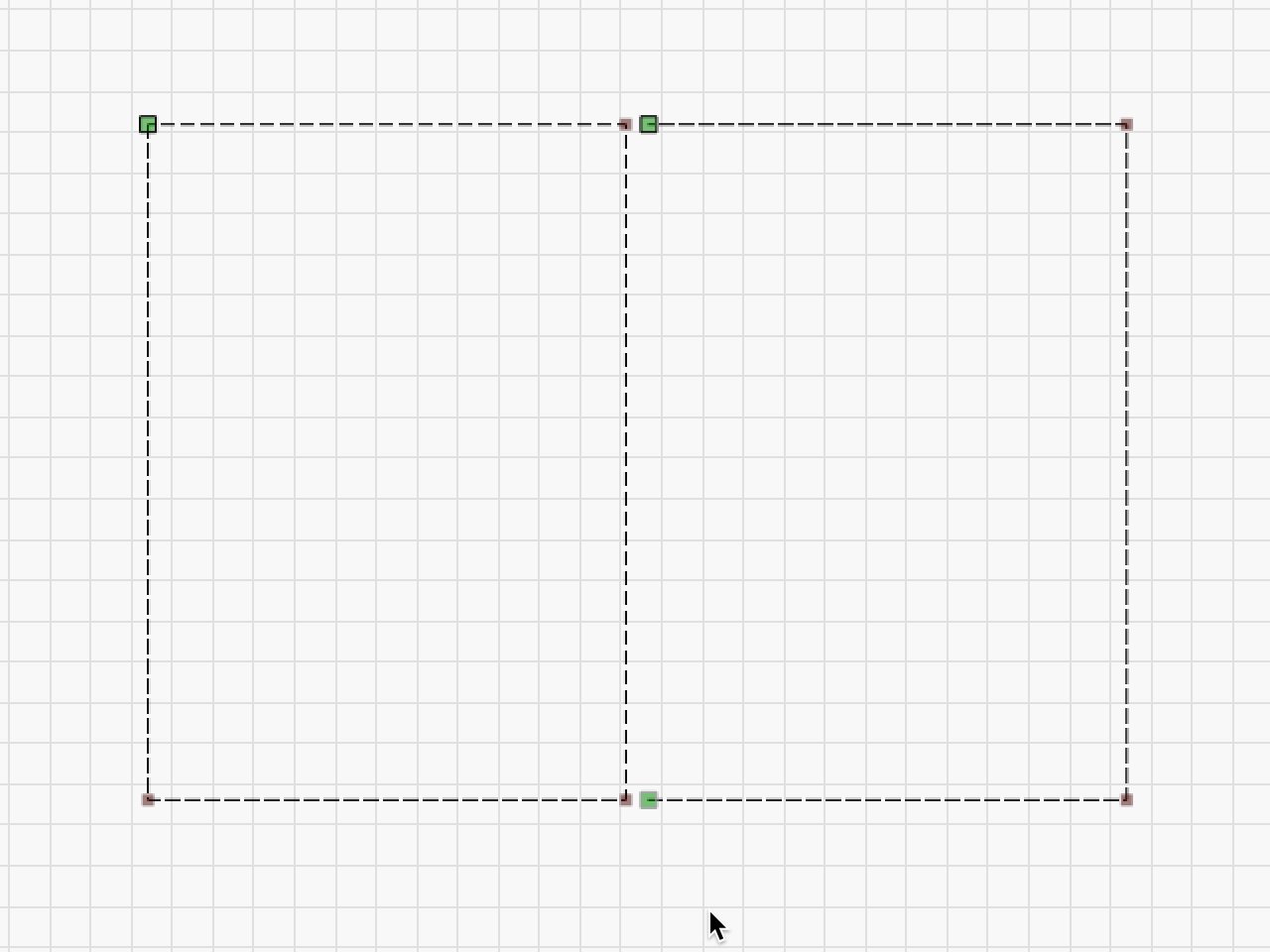

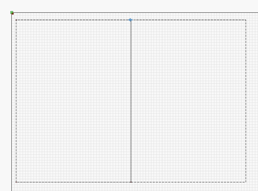

Sorry for the slow reply. Offline a bit. Yes, it is simple to recreate. First, make sure cut optimization is off. Then…
Create a rectangle, duplicate it, move duplicate to left so both rectangles share the middle vertical, convert left rectangle to path, break the right hand nodes of the left rectangle (top and bottom), delete the duplicated line. It will now start by cutting the right rectangle, then cutting the remaining lines of what was the left rectangle. Hope this helps! Of course, with cut optimization toggled on, there is no problem.
I can’t reproduce your original file. I’m working in v1.0.06. I’ve separated the squares to make it easier to see.
