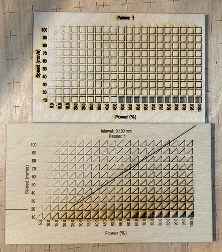

I ran a material test in 1.6.03 and in the latest beta that I could find 1.7 Beta 10. The engrave actually looks better in 1.7 but the line test doesn’t seem to be respecting power levels
Bottom is obvi 1.6 with the triangles. Text as line at 60mm/s @ 17.5 power for both, but the top (1.7) is just scorched. On the back side all the corners are pinpricked through the material (3mm BB)
I’ve set it up as an XTools device, with all the settings recommended in other forum posts. Thoughts on what I could be doing wrong?
