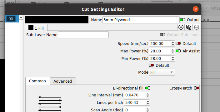

The interval is another way of specifying the dpi/lpi… You could enter the 540.43 into the lines per inch field and Lightburn would populate the interval field…
1mm/0.047mm = 21.278
21.278 * 25.4mm/inch = 540.4255 for dpi/lpi…
Have no idea why it would display 21.28… mine shows correctly as the 540.43 value in the lines per inch field…

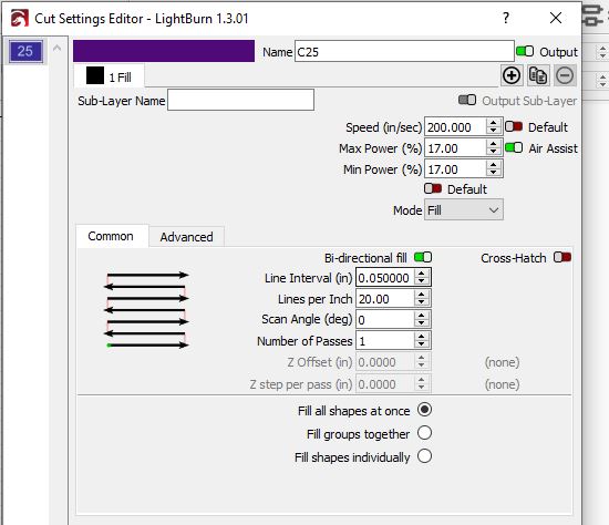

Can you do a screenshot?
Capture
Enter the 540.43 in the lines/inch field…

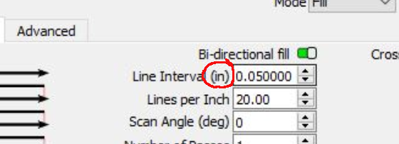

The problem is you are entering the interval in inches, not mm.
1÷.05 = 20.00 lines per inch, all of it in inches.
Somewhere you are set to inches… maybe here…
Notice mines in mm and shows the expected values…
