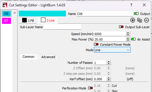

Went on the laser today to do a couple of jobs and clicked preview to check it out and nothing showed in preview window.
After checking the settings I found that fill worked but not line.
Everything worked fine a few days ago.
Any ideas?

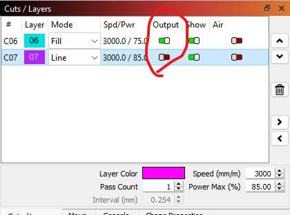

Is it set to output? Either in the Layers menu,
or in the Cut Settings?
All settings as they should be, if I deselect line from output preview shows the fill, but enable the line and it shows nothing, as if it was outside the workspace.
grrr
