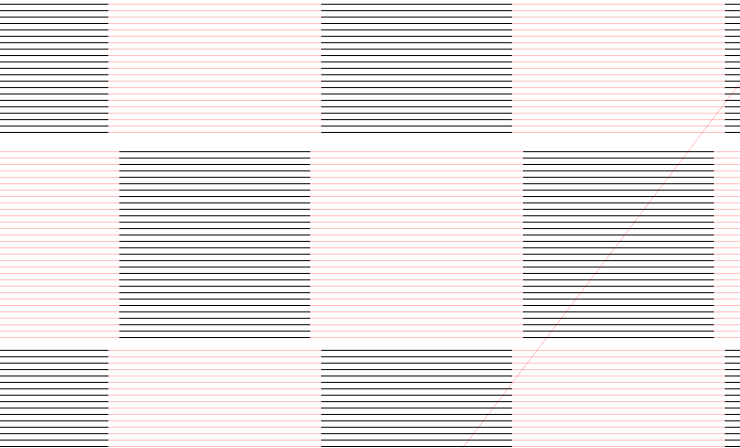

I’ve been tweaking some parameters in prep for image burning on tile (Ti02).
I have the speed/power down, line spacing good, and am now working with dot size compensation.

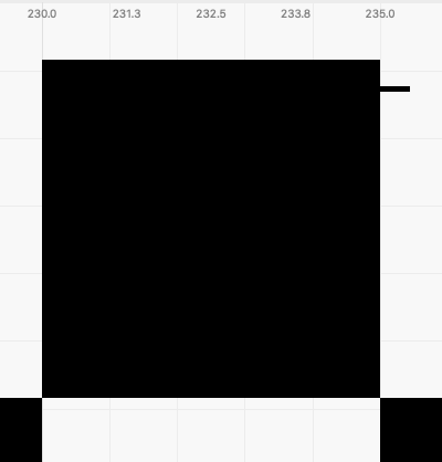

I created a 5mmx5mm black square (GIMP) at the target LPI and save it as a bit map.
Imported into LB and arrayed as a grid to check line start/end alignments.
Here is a screen shot of the LB workspace. Squares measure 5x5 and touch at the corners as I wanted.
(zoomed in)
Screen Shot 2023-07-02 at 3.08.39 PM
This is what shows up in preview and is also what was etched on my tile except the tile has proper vertical spacing, only the X-axis appears “short”

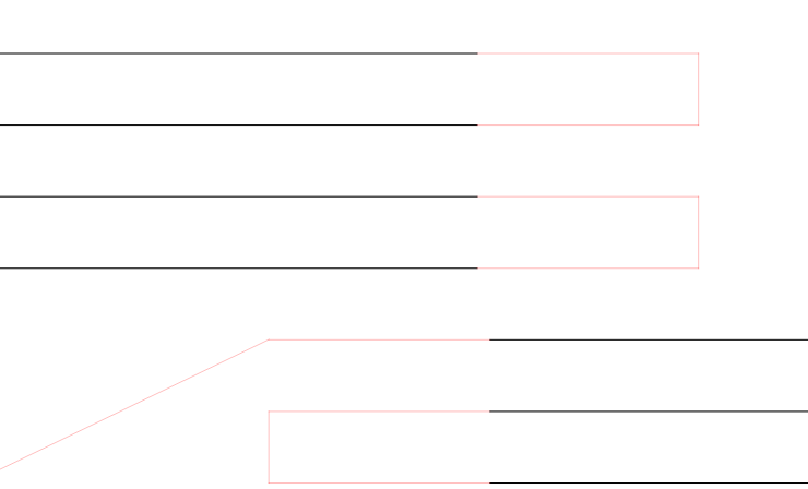

The squares appear good vertically (Y-axis), but the horizontal line length seems shortened at the start/end by about 0.2mm.
With the Line Offset tool the line length can be extended so each line ends at the desired spot, but the start points are still offset.

Upon closer examination, there is what looks like a missing line scan on the top/bottom of each square. Should mention I added a hopefully generous overscan of 5%, but the results are identical compared with the default 2.5%

The workspace represents what’s provided to the rasterizer for processing. Somewhere in the rasterizing process you’re getting this behavior and that is what is shown in Preview.
I do find the specific behavior a bit odd. Initially I thought it had something to do with dot size correction but changing that didn’t seem to make a difference there.

So, I went back to my original image, a 5mmx5mm bit map (.bmp) square.
I believe the “odd” deviations at the start and end of each scan are artifacts from some DPI related interpolations going on between LB and the file I saved.
This time I made sure to specify a .bmp with dimensions of 5mmx5mm at 6.00 DPmm (dots per mm). This resulted in a .bmp with pixel dimensions of 30x30 (6DPmm * 5mm)
This works out to 152.4 LPI. If I use that value in LB, things look much better horizontally (X-axis). I can see the possibility of interpolation resolution causing the length problem when I tell LB 160 LPI.
If I use the .bmp and also choose “Pass Through” in the layer controls on LB (LPI becomes disabled as expected), I get proper X alignment. According to the G-code, the Y step size (G1 Y0.167S0) matches the .bmp resolution of 6 pixels/mm) There is even the occasional (G1 Y0.166S0) to compensate for residuals so long term the 6pixels/mm is maintained.
Accordingly, preview shows my “Dot Compensation” (here set to 0.03mm) is the only gap remaining.
If I set DC to 0.00, the gap disappears.
Still curious is the gap (single scan line width).
Of course since each square is touching at the corners, there should be no overlap in either X or Y but it seems to jump a full line width (based on the LPI) versus a probably more appropriate zero jump.
Each square was scanned individually so something moved the start point. Of course if the start point (Y axis) was maintained, the squares would slightly overlap by 1/2 their actual burned width.
Maybe somewhere there is a <= where just a < would be correct?
