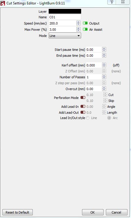

Just installed a C3D laserboard and added a diy rotary and having a few problems I’m hoping to get some tips on. Problem 1 is the burns seem to be hotter (darker) in the A axis rotation than in the X axis in places. Problem 2 is corners aren’t always closed, and problem 3 is it seems the laser is skipping line segments in places. I’ve exported the gcode and at least initially on the first letter that’s missing segments on, the gcode shows it’s enabling power to the laser. I don’t really know what else to look into so hoping someone can point me in the right direction.

I’ll try changing the speeds to see if that helps the burn. On the minimum cut % this is just line so I don’t have a min power % option, unless your talking about something else? In the pictures in the first post the first picture you can see “Cyn” toward the top and on the bottom a upside down “di”, these were different tests with same results of having missing segments. All letters are supposed to be closed as in the second picture preview. Also at the very top & bottom are a few different test of 3 squares12mm each contacting each other that show both the corner segments missing and the different power being put down.

No it only shows Max Power. It seems I can only see Min power with an Image but even then it’s Grayed out and not selectable which is something new I’ll have to chase down. I’m new to the Smothieware and rotary so everything is a learning curve right now.

If you’re running Smoothieware on the C3D (the default / stock firmware) the minimum power setting is handled by the controller itself, not the software, which is why you don’t get that control.
On the SD card is a file called config.txt. Open that in Notepad and look for a line that says:
laser_module_minimum_power           0.0
The number is from 0 to 1, and is the minimum power value for cutting moves. You should set this to just below the firing threshold of the laser, and you’ll have to find that by trial and error. If you have a 40w laser, a good starting point is 2 to 3 percent, or 0.02 to 0.03. You want the number high enough that it cuts the corners properly, and low enough that it doesn’t fire in the gaps when engraving.

Thanks, making the A axis speed the same as the X axis in the config file and changing the laser_module_minimum_power to .02 seems to have fixed the majority of missing segments and open corners. So now I think my only problem is darker burn in the A axis direction. I’m thinking it has to do with gear reduction slowing that axis more than the X possibly?
