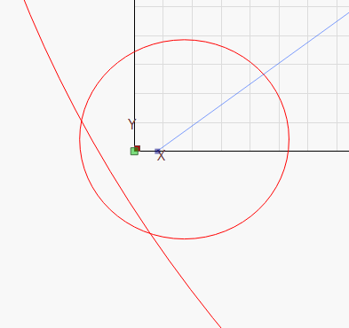

This happens a lot. I don’t know the cause but almost every shape I draw with the line tool, it does this to one of the grid corners. Any way to stop this from happening?
Just turn OFF Snap to Grid in the Settings window?
It still does it with that setting off. I even turned off “Snap Objects” as well.
Is this what you are talking about? That is NOT a Snap to Grid result.
With Snap to… turned on, you can hold the CTRL key and it will override the snap.
I tried using CTRL for some shapes and some without and they still had this result. The only way I can fix it is if I use the “Edit Nodes” tool and drag that node from the very bottom corner to the middle and delete it. The shape goes back to normal afterwards. It’s tedious and I’m curious as to why it’s doing this.

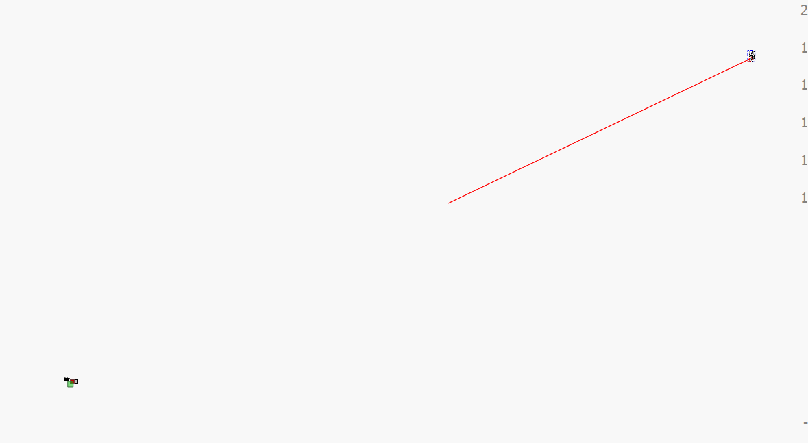

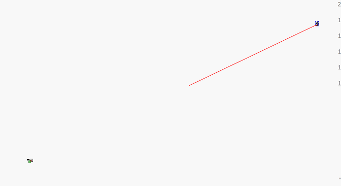

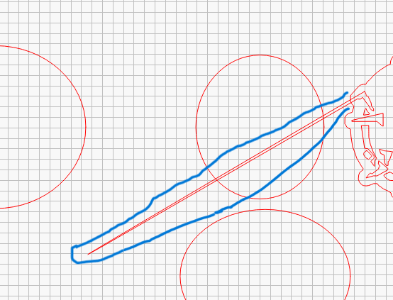

Is this what you are talking about? It would help if you showed us instead of me guessing…
Yes that is what I have been referring to with the image.

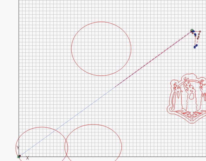

Here is the same issue with another shape with Nodes enabled.

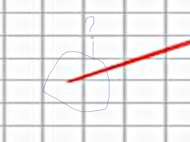

This is the node up close
