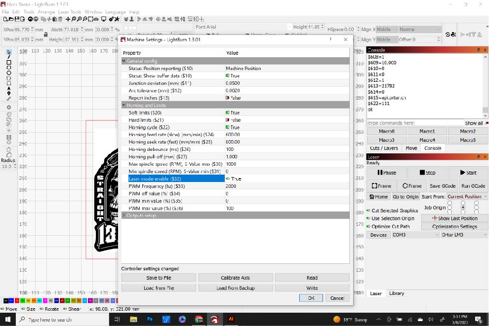

No matter the speed/dpi/overscan/power/type I am getting lines in everything. Belts are tight, laser is clean. I used the Laser Explorer App and I had no lines at all and it was perfect. I must have something set very wrong in Lightburn but I do not have a clue what.
From the grbl documentation…
You might need to enable “Laser Mode” if you have GRBL 1.1f or later ($32=1)
This puts the board in laser mode. Most cnc machines do not turn off the spindle when it’s moved, sounds like that’s the problem.
Good luck
Thought it was fixed, its not. still have a ton of lines through the image.
I went online and looked at all the settings docs and saw that my move increments were off by 1-7 on 2 of the settings. I have no clue how it happened.
