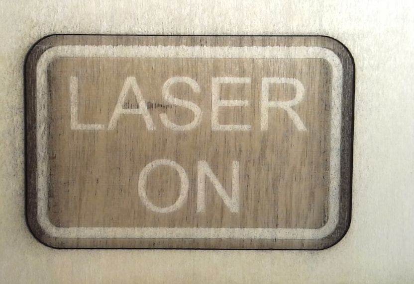

Lines in relief fill engraving
In my experience, the ortur laser is easier to run when units are set to mm/mimute. Not sure what you are using.
2000-3600 mm per minute is a good rate.

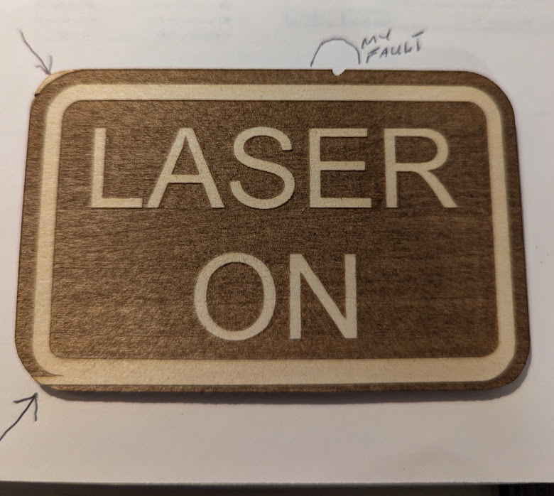

My output (previously used scrap wood)…
Mikey
I ran the file you sent me and it worked a lot better with 2 flaws,actually 3 flaws but the 3rd one was mine because I had to use a piece of wood that barely fit the sign and a cut from a previous job is present in the new sign.

Better, but still not acceptible.
That shows your machine is 98% okay and Lightburn is 100% okay. I am guessing here, but those 2 areas suggest the laser is turning off during motions at the far left of the travel. I would look at the cable going to the laser module: loose connector or intermittently broken wire.
Because my setings are all mm/m for the laser motion. I design in both inches and metric, but moves are always metric (this has been said best for diode lasers at least 1000 times on the Forum). They came up incremental because you are not using the same units.
It looks like you are using in/m for motion units. Look at the number conversions…

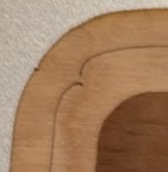

This is the final results I got after doing the many suggestions you all gave me.There is a slight “glitch” in the upper left corner but I can live with that.
Thanks so very,very much for all your help!
Tom
Have you checked the source to see if that ‘glitch’ is there? That or preview should show you.

No glitch in the preview window.
To be honest I don’t really know other to follow all of the instructions I got from all of the guys.
I did change everything to mm which I’m having trouble dealing with but if that fixes things I’ll suffer through it.
I did check all of my wire connections and complettttttely reset buth my laser and downloaded the latest version of lightbur,I had gone back to 1.7 earlier but that didn’t fix my problem.
One of the guys ,I think Melvin but I don’t remember gave me his file of this project and after that it looks like all is well.
Sorry I don’t have a definitive answer for you.
Tom
You can change your project creation to inches and laser speed to mm/min. It’s what I use, As I’m not comfortable dimensioning in MM.
This is still a problem, maybe a mechanical issue.
