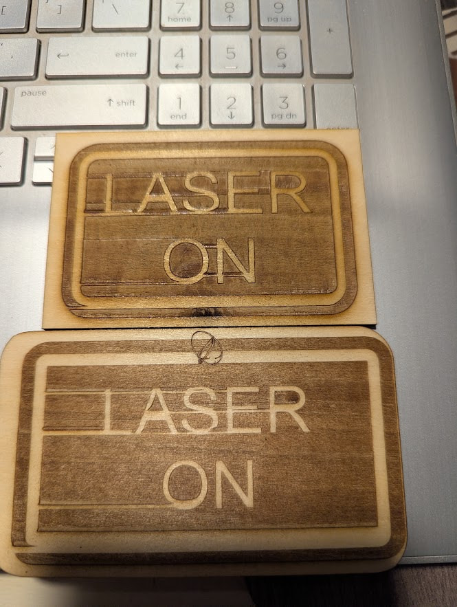

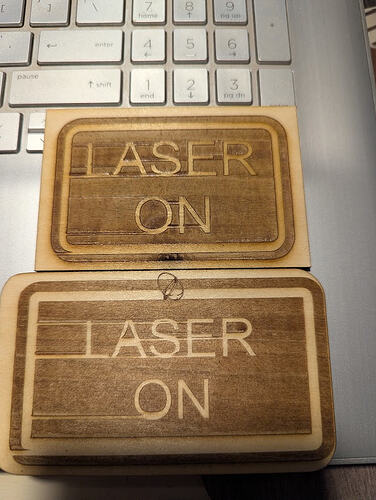

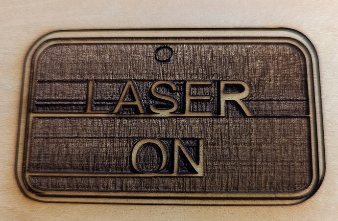

I have ortur lm3 20w diode laser with windows 11 on a lap top.
I’m getting lines across the engraving,

I’m not sure I’m asking the right question but am doing my best at age 82
Thanks,
Tom

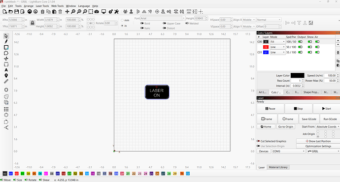

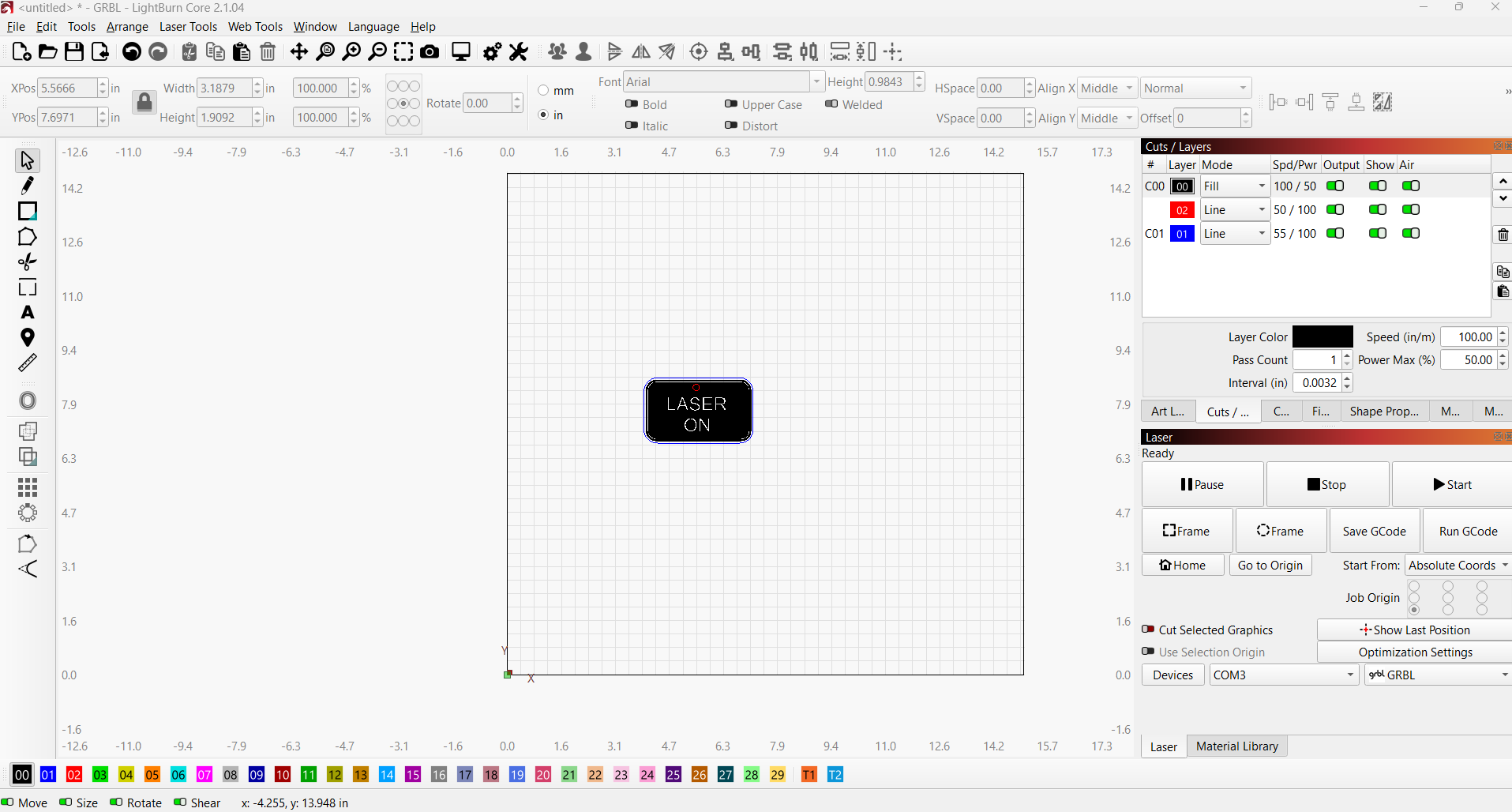

Show a screenshot of your LightBurn-window. And also show the layer settings you used for the engraving layer. This can be caused by many factors.
Show us your preview windows, in addition to the above requested screenshots.
I hope this is what you guys wanted,if not ask and I’ll try my best to do what you ask for
Thanks,
Tom

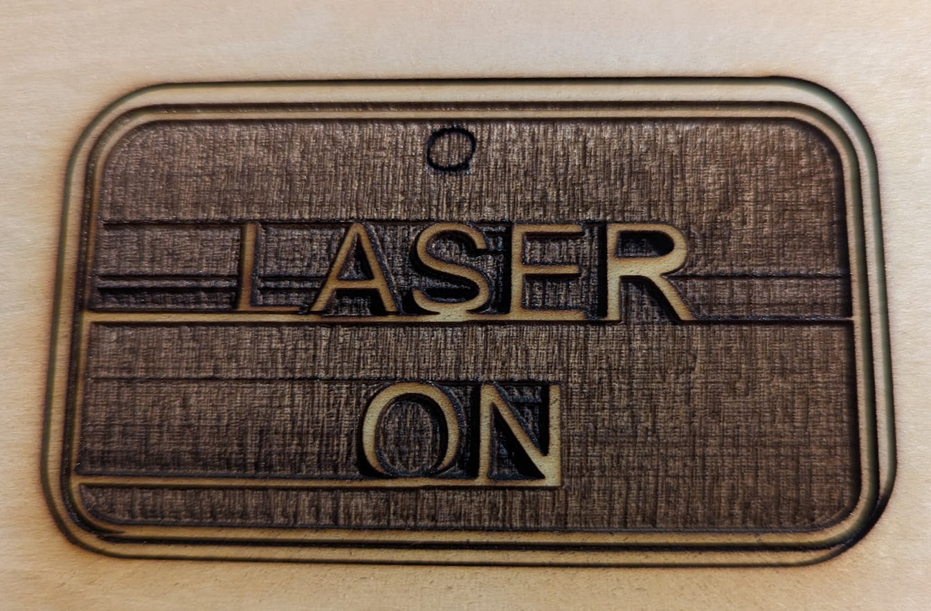

Is this possibly a material problem? Have you tried this on different material?
I ran 2 slightly different jobs on different places of the wood and ended up with the same results.

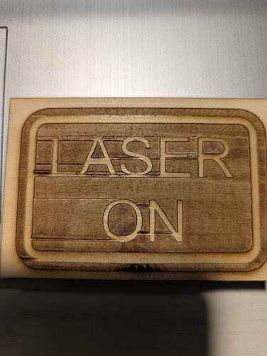

I would switch to mm/min. But at any rate it looks like speed is way to high. I work around 2000mm/min and yours is 12700mm/min
Thanks,I’m change my settings and give it another try.
It doesn’t really matter what units your speed is. 60m/h is the same as 96.56k/h. If you do the conversion correctly, it doesn’t matter what units you use.
I keep all of my machines, from visible laser to fiber in mm/s. I can see how fast it’s going and I can tell if it’s tool fast or slow. I’m used to mm/s, so that’s what I use across the board.
Saying that, if you’re hunting around for power/speed numbers it’s likely you’ll find more in mm/m for a visible laser, then mm/s.
:grinning_cat:

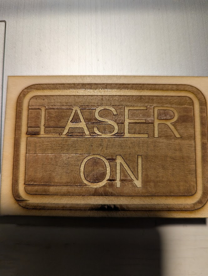

I uninstalled the latest version and downloaded version 1.7.08 and am still having the same problem.

I downloaded the latest version of lightburn again.I reset my Ortur LM3 20W back to factory settings am running Windows 11 on a laptop pc.
I never had this problem before and the only thing I can think of that is different is that I ran a project on the Ortur YRC rotary unit but I did type $=22=1 $141=1000 and turned off Enable Rotary in the rotary settings.
If you reply to this please make it as detailed as possible because I don’t understand most of the tech lingo.
Thank you all again for helping me and being patient.

Can you upload that Lightburn file (.lbrn2)? It would be helpful to see if it does the same on other machines.
I’m sorry but I don’t know what you mean or how to do it.
I’m 82 years old and not tech savy
Drag the file from Windows Explorer into the Reply box. Or use the little upload arrow at the top of the Reply box.
I am 80.
laser sign.lbrn2 (25.8 KB)
The file you supplied does not have 3 layers in it. We need the actual file that you are running to test with.
If this file is your latest attempt, I would try turning off flood fill in my cuts/layers window. It maybe causing issues.
Again I’m sorry but I don’t know where it is
I didn’t post photo’s but I ran it in both fill and flood fill and it didn’t make any difference
