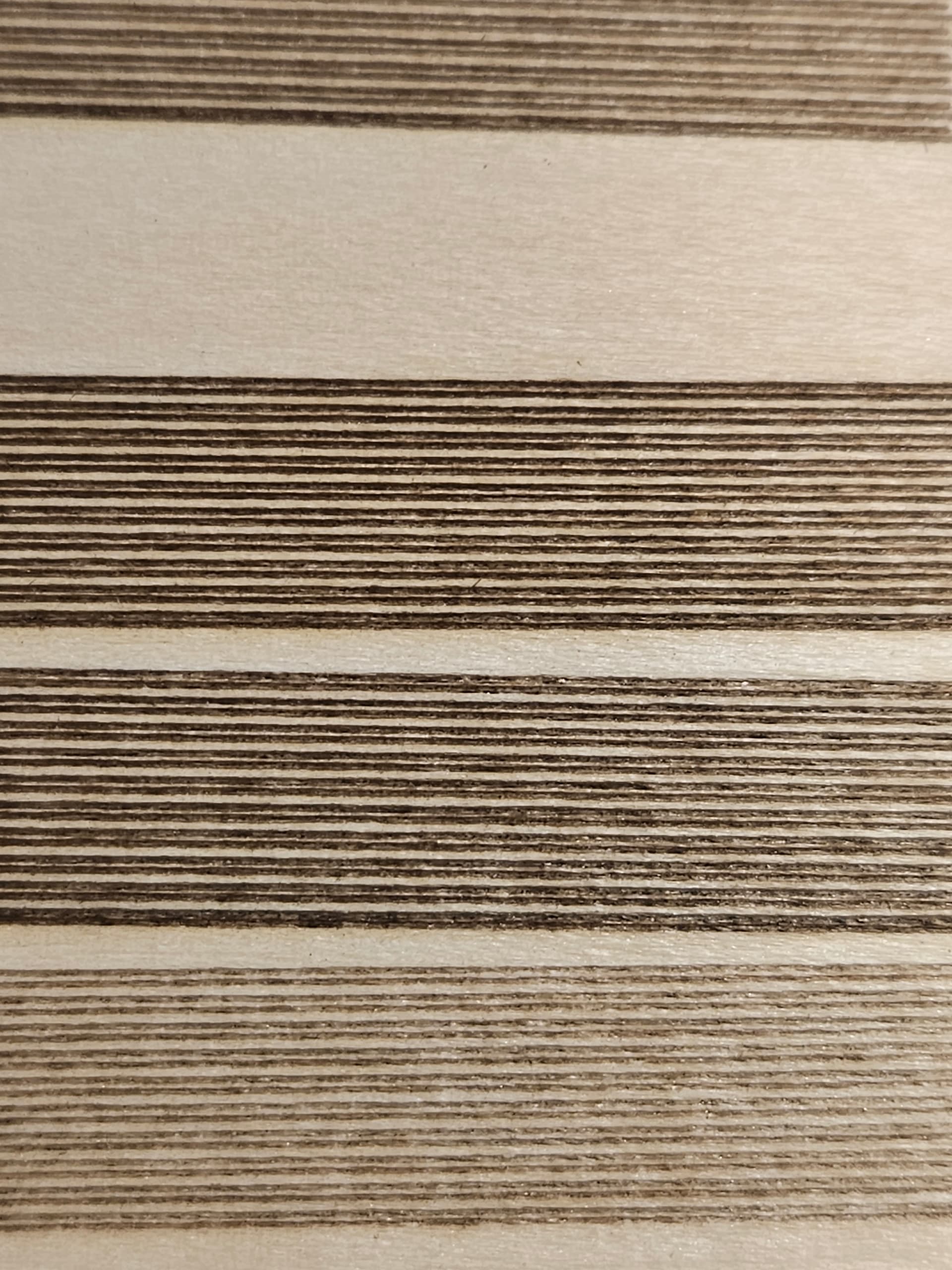

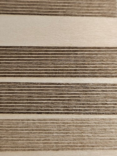

Hello! I’ve been doing some scanning offset adjustments as I’ve realized my engravings on my Falcon 2 40W(in precision 22W mode) are not coming out okay. It made the results better, but I’m wondering if my issues are arising from this strange movement from the Y axis.
Even though I’ve set the line interval to .5mm, it seems to be consistently changing from a .2 interval to a .4-ish interval every other line. I’m thinking this may be an issue with my belts, but I am new to this kind of hardware, and wondering if anyone else has experienced uneven line intervals! Where should I start troubleshooting this type of issue? Thanks for reading, I appreciate any input!
Hey! I took the falcon 2 apart and adjusted the eccentric nuts on the machine which was causing the hitches in both the X and Y axis belts. It seems to be easy on the Y axis, but on the X axis it can be a bit sensitive to adjusting the eccentric nut. Too loose, and the laser attatchment plate will wobble. Slightly too tight, and I get evenly spaced bands of increased resistance when pushing the laser module along the X axis. I still have a bit of wobble, but it is a lot better than before, and within acceptable tolerances to continue fine tuning the machine.
