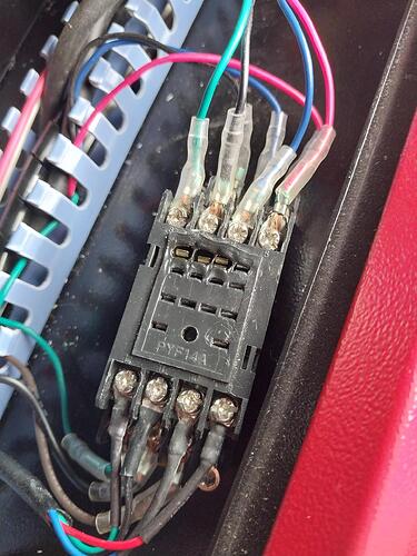

Lines on circles and rect. not smooth. Belts and rails all good. Engraving pics looks ragged. Really

Did that but would be happy to do again. I have an 80 watt I ordered with rotory setup and didn’t realize they put a relay in to switch the Y off making it not necessary to disconnect it for use. After pulling most of what’s left of my hair I discovered in a dark place the relay. I checked it and it showed some heat effect on three of the pins. It took me a while to examine the socket and I saw melted plastic and saw that the sockets had shorted. It was totally unknown to me how the system worked so it took many hours to finally trace the issue to the relay. I ordered and replaced the relay and socket. Back in business. There was nothing, as usual, with Chinese products about this feature.
The Y motor was getting signals not intended and it simply had no rhyme or reason in it’s travel.
Hope this helps someone in the future.

Now, that is downright ugly!
It looks like they’re hot-switching the stepper motors, which is both not a good idea and not at all surprising.
