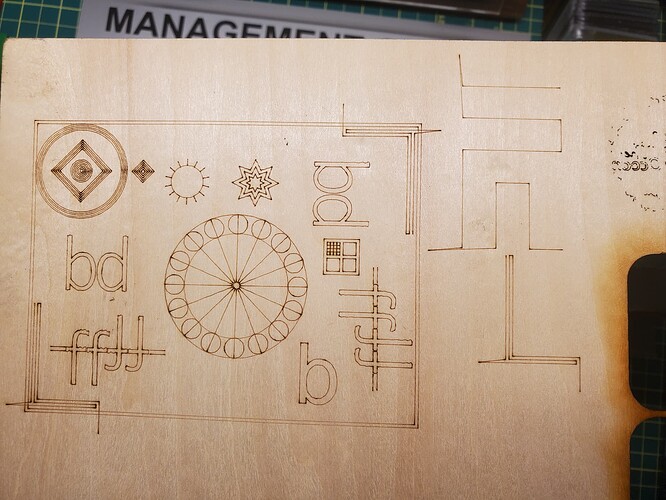

Im having an issue that is becoming more repeatedable the design on lightburn shows the layout properly but when i start engraving the line layer shifts to the left and overlaps another text layer i have attached the lbn file along with the picture of the issues it happened before on another file that i was trying to engrave.

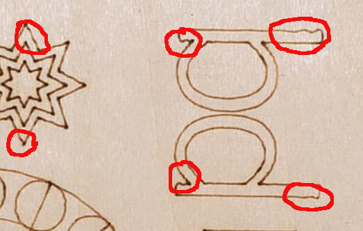

I did the backlash test, the lines most of them were fine, the test was conducted at 300mm/s but if you can notice the letters f & b had bumps along the lines, the distances on the right side of the drawing match.
we ran the job again, but with having spaces between the pieces inside of having the frame lines overlap and it works flawlessly, we have a suspicion that when we have the frames of the pieces overlap and set remove overlapping lines in the optimization settings on it causes this issue, but when we set them apart it works, but I’m not sure how this can relate to that.
In regards to how I ran the job, we set the fill red layer running first as I turn off air assist, then run the green engrave line and cut lines after with air assist on. the work area I’m working with is 20x28.
All of these in red are from a mechanical anomaly. Something is loose…
It’s occurring when the axes change direction. This direction change causes a ringing in the mechanics.
Something is loose in the Y axes direction…

When I ran it at slower speeds 30mm/s the ringing disappears, but I will do a check on the screws to confirm, as well thank you,
but I don’t think this is what causing the main issues of the topic tho.
Agreed…
However, if it isn’t working right, then there is a problem… Clean them up as you go.
The wobbles suggest there’s something loose in the laser head shaking as the direction changes. It eventually settles down at (mostly) the same place for the test pattern, but it may not behave that way on your layout.
However, that cannot account for both problems in your photo:
The text is misaligned horizontally with respect to the vectors and we can eventually figure out which layer is actually offset.
However, the vector to the right of the JB box is broken. The LightBurn file shows that vector as a single stroke, so it should be drawn in one continuous motion. Looking at the photo suggests the laser was off when either the head or the material moved a millimeter or two along the Y axis, which seems impossible while the job was running.
Did you pause the job in the middle of that vector when you saw the misalignment around the JB label, bump the material, then cancel the job? I can imagine the controller would finish the vector after restarting, before cancelling the rest.
If that’s not what happened, what did?

To answer your questions, the whole vector part of this drawing was on a separate layer, and that layer started after the text(fill) Layer, I send the fill layer separately as I need the air assist to be off as it usually provides better results, then I turn it back on and start the cutting layer (line), I was keeping an eye on it and the moment it happened it stopped it, but that whole upper line and boxes of the far top right are part of the same layer that was running continuously, ’
If you take a look at the pictures below, the issue replicated on another job we did previously, with the horizonal misalignment between the text and vectors. That’s why I believe its more of a software glitch as we have the theory above and not sure if it even makes sense.
