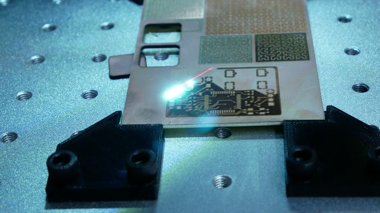

One of the devs used an RF Galvo to etch then cut-out a circuit board.
It’s absolutely mesmerizing.
