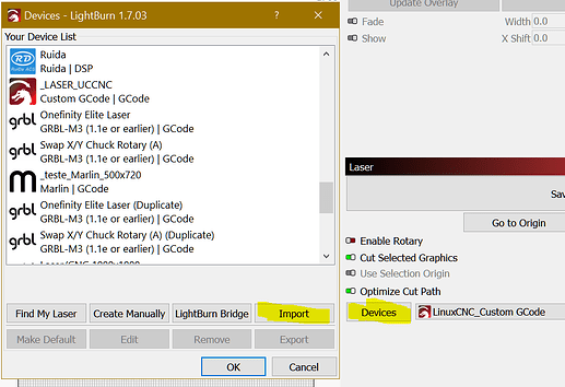

Try with this device LinuxCNC_Custom_Marlin.lbdev (3.8 KB).
Is Marlin based for a 1200 x 1000 laser, IP:192.168.8.10 import and adjust per your settings. I think you´re better served with Marlin flavor.
Click Devices then Import and OK. After select your newly imported device and configure/test.

The Marlin device I posted already has the output tuned as LinuxCNC.
I have linuxcncrsh working pretty well with the modified Marlin device. I still have a C++ program formatting/translating between LightBurn and linuxcncrsh. I found a couple problems with linuxcncrsh, and I’m evaluating changing to a python interface that I think is more up to date.
