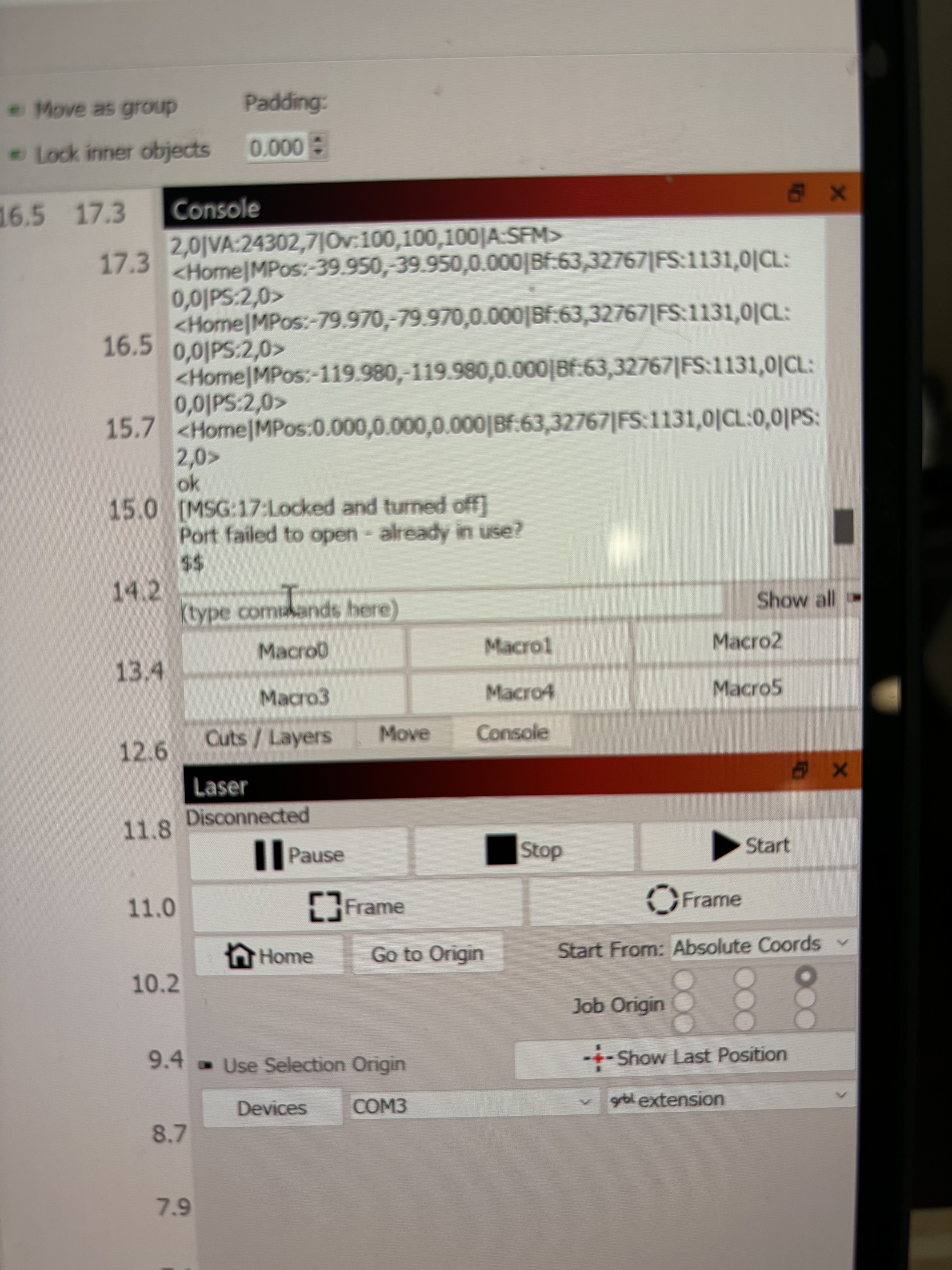

I am having a project stop mid burn on LM3, I recorded for Ortur- 20 min in, laser stops, but indicates “busy”. I am getting no where with Ortur. I am usb connected from laptop to laser via usb.

Type $$ on Lightburn console window and copy/paste here the output.
With the mouse pointer select the output in console after the $$ and copy then paste here in a post.
I am not seeing “output”

The slider is all the way down, there’s nothing after the $$ signs
Sorry, not seeing this.
Your laser need to be connected to Lightburn.

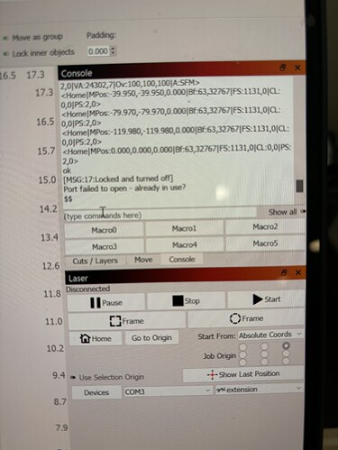

Now after that- my laser is busy and a bunch of ?’s have shown up in console
This is a very very old firmware and you would really benefit of an update.
As @parsec said a test you could run is unplug the laser head cable - run just the motions. As in, run the project but without laser head attached.
OLM3 will move but not engrave.
Same errors?
What is odd is “Locked and turned off”
That could be the auto power off feature though.
So firmware 1st, test of laser unplugged 2nd.
