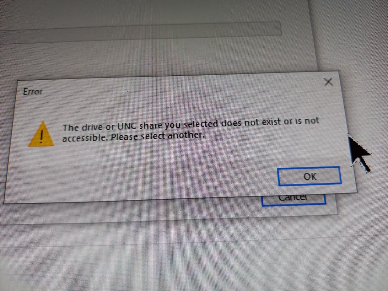

I have just purchased and downloaded version 1.6.0 but when I try to install I get a message"The drive or UNC share you selected etc." makes no sense to me . I have been using LIGHTBURN for several years and always purchase the latest version but have never had this problem before, is it me or is it the update that has the problem.

and this is the message I keep getting.I always keep programmes up to date ut have never had this problem before
What free version are you referring to? And did you purchase a new license or a renewal license?
What is the screen prior to this one?

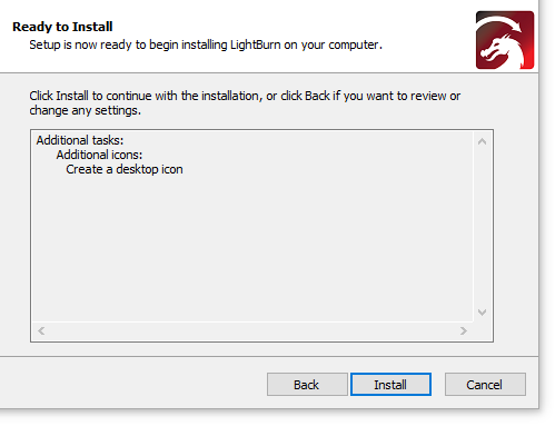

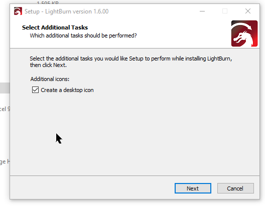

the previous screen was just "Do I want to have a desktop icon or similar. I still want to know what that message means, I tried to download a previous version and still I get that message which I do not understand and have never received before this, it seems to be about the download procedure even from HQ.
Can you post the exact screenshot please? Is it possible that the location of the desktop shortcut that’s trying to be created is unavailable?
Ashampoo_Snap_Tuesday, May 28, 2024_12h44m19s2024.05.282024.05.2812h44m19s
Ashampoo_Snap_Tuesday, May 28, 2024_12h42m57s2024.05.282024.05.2812h42m57s
If you don’t need a desktop icon, then unselect that box. The error you’re seeing may be related to server/remote/cloud storage that is not currently connected to your PC

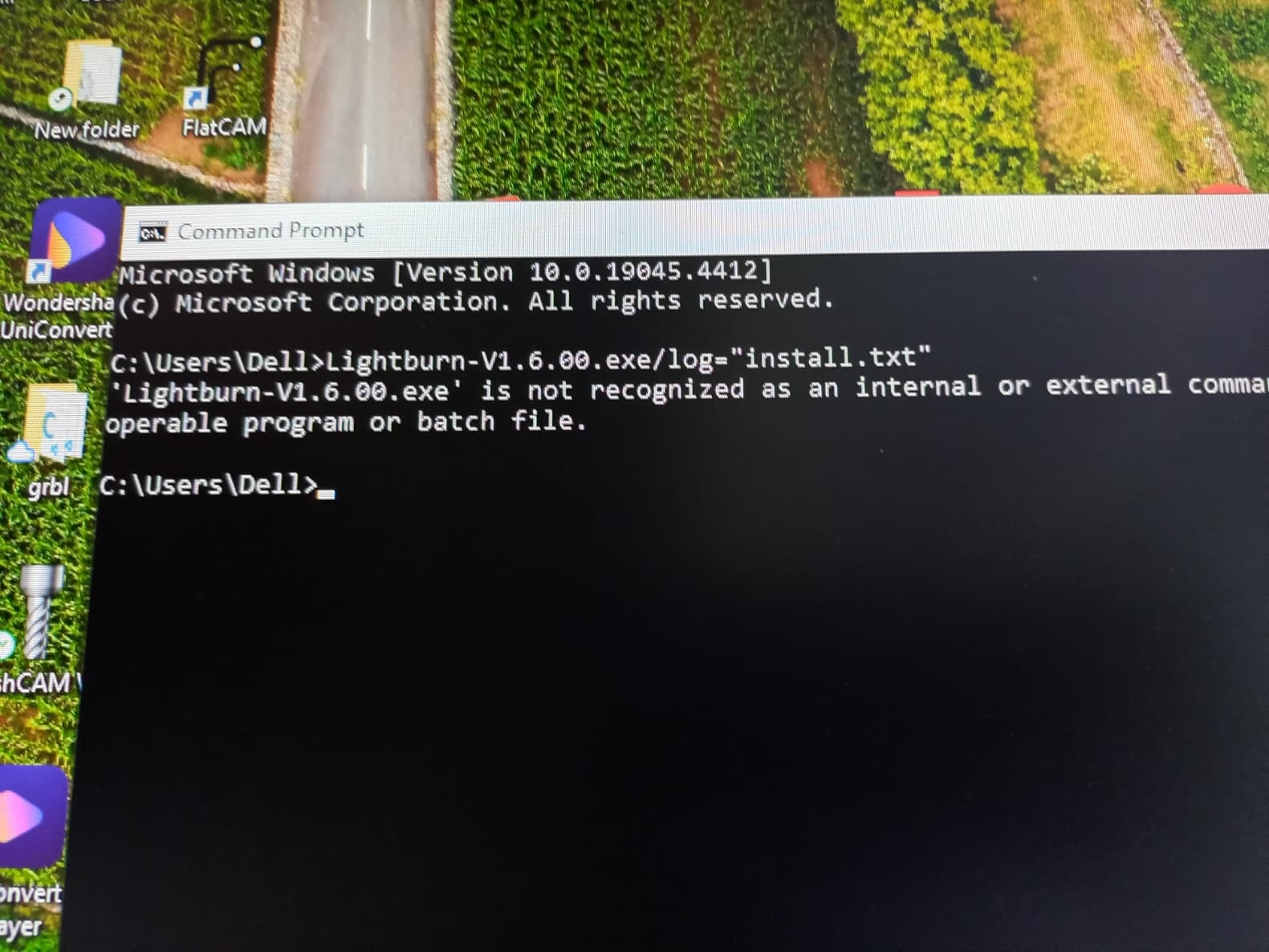

Can you try running the installation file from the command line? Open a CMD prompt, navigate to where you downloaded the file and then type this:
LightBurn-v.1.6.00.exe /log="install.txt"
After the installation fails, locate the log file and upload here.
Hi,
Sorry about the delay, I Tried that and the message back was “lightburn.v.1.6.00 exe non recognized as an internal or external command”.
I did try a search for “…” but it came up with several solutions, all quite longwinded and seem to involve loading a program then deleting ??
Sorry, there was a typo in the command. Try this:
LightBurn-v1.6.00.exe /log="install.txt"
Assuming you are running 1.6.00. If you’re running something else then adjust accordingly.
Hi, thanks again, tried the corrected text the answer was still the same
Can you take a screenshot of what you’re seeing please?
![20240603_102152|666x500]
Basically that’s indicating that the command, or in this case, the application itself cannot be found in the current directory. What specific version of the file are you trying to install? Can you take a screenshot of explorer or list the contents of the directory that you’re in?
Make the correction to the proper version/filename and run again. Note also that you’d typically have a space between the name of the application and the forward slash symbol.
