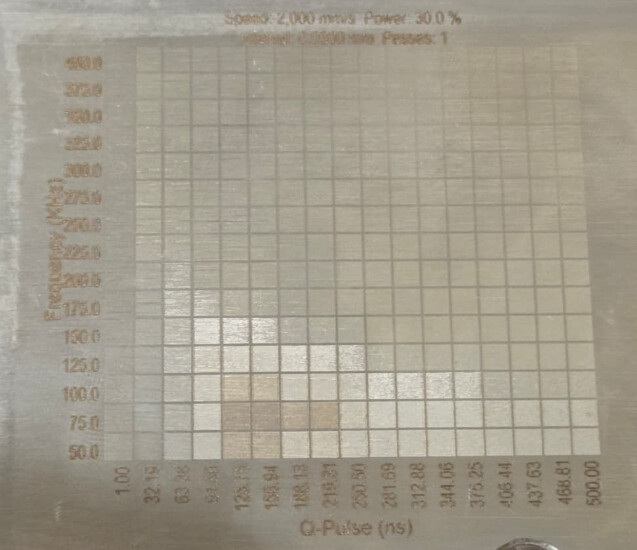

it does actually seem to round to the nearest value with a JPT M7 E2 source
also, @Aaron.F, your preset was translated into “pulses” and “frequency” for me, not sure if that’s a bug

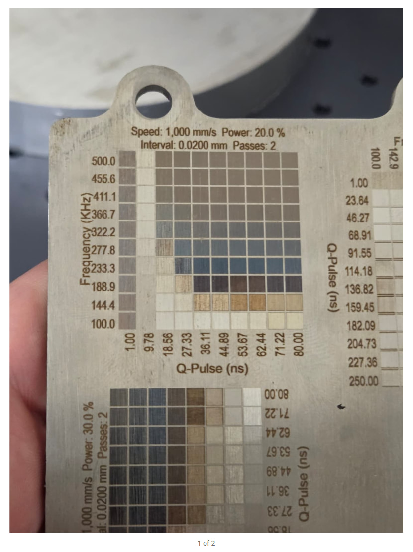

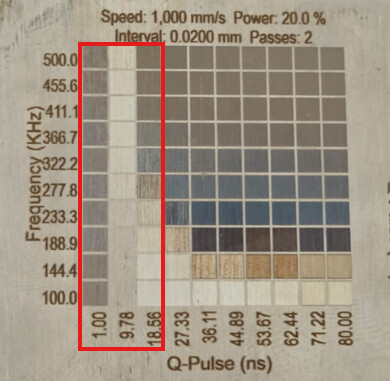

I’ve seen the same situation where the initial column was way different, like in your first picture at 1ns.
It would be interesting to see a couple more step values between 1 and 10 ns.

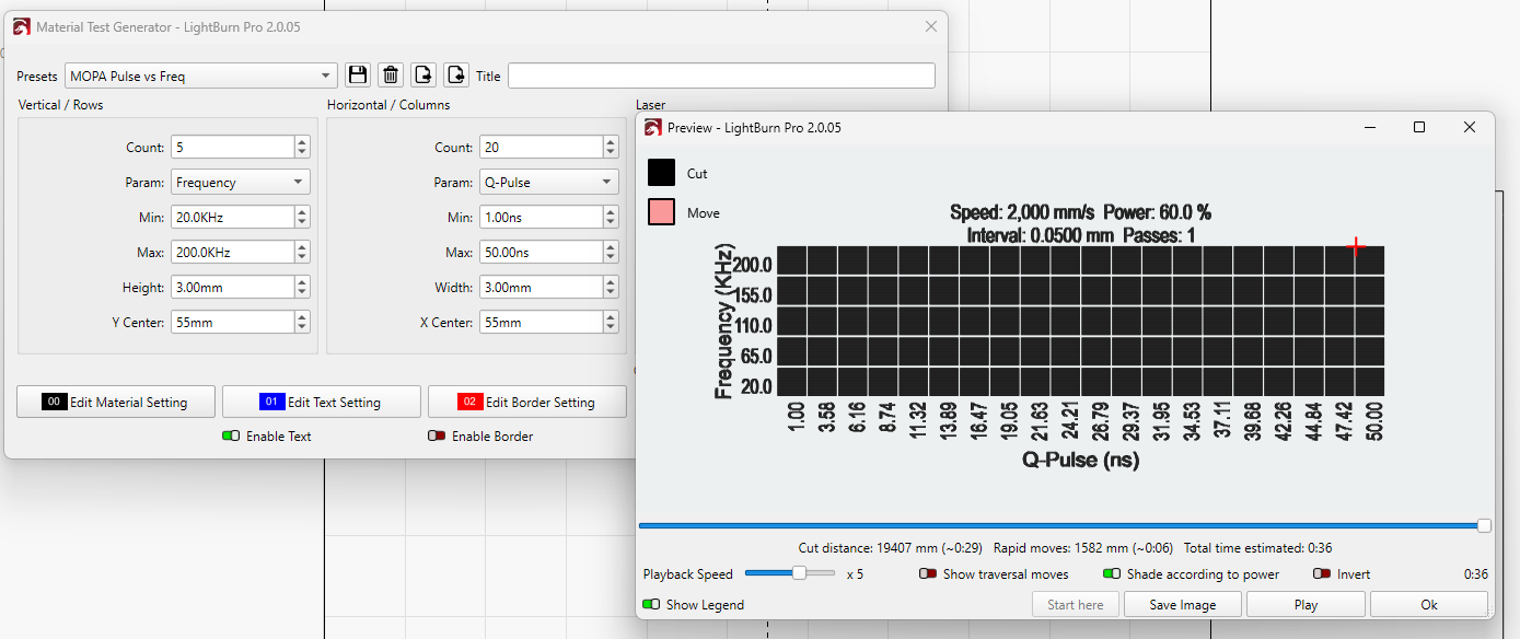

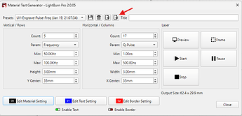

Yes. I’ve set the Material Test to show the relationship between Frequency and Q-Pulses as shown in the screenshot of the preview above. (I have now adjusted the screenshot below so that it shows the same values as in the .lbmt file.)
We’re more interested in the Q-Pulse, so I’ve set the “Count” to 17.
You did something similar in the second picture, but with only one pass @30% power, so the effect is less telling.

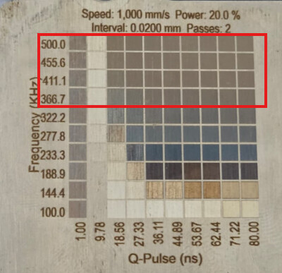

There’s not much variance above 322 KHz. Use that as the Max value in the test generator.
Something like this could provide further insights:

All my test it rounds to the nearest valid value, not last valid value.
Thanks for confirming. This is reassuring.
