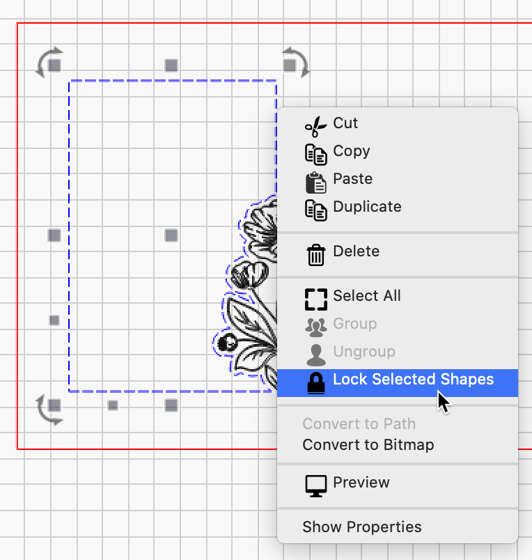

Select a thing and right-click, you should see the ‘Lock Selected Shapes’. ![]()

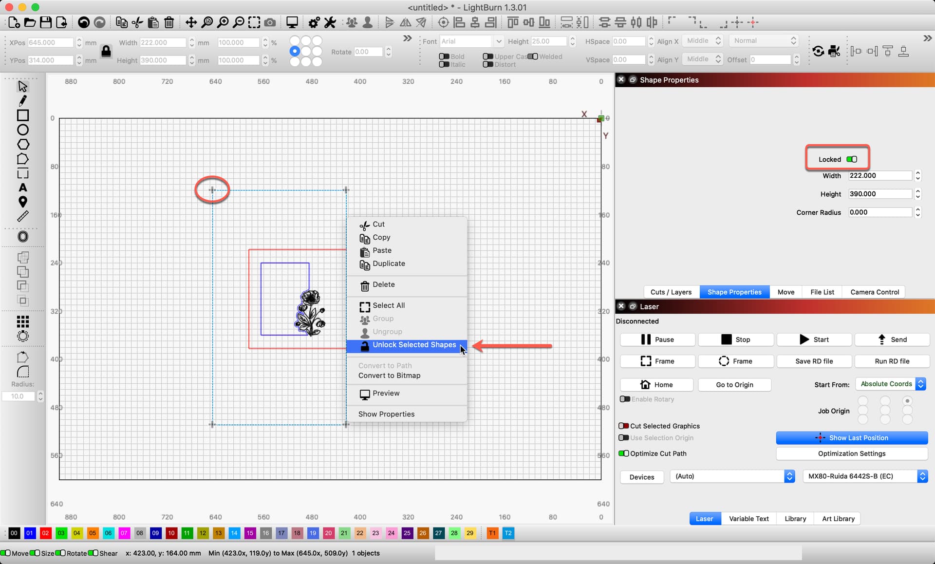

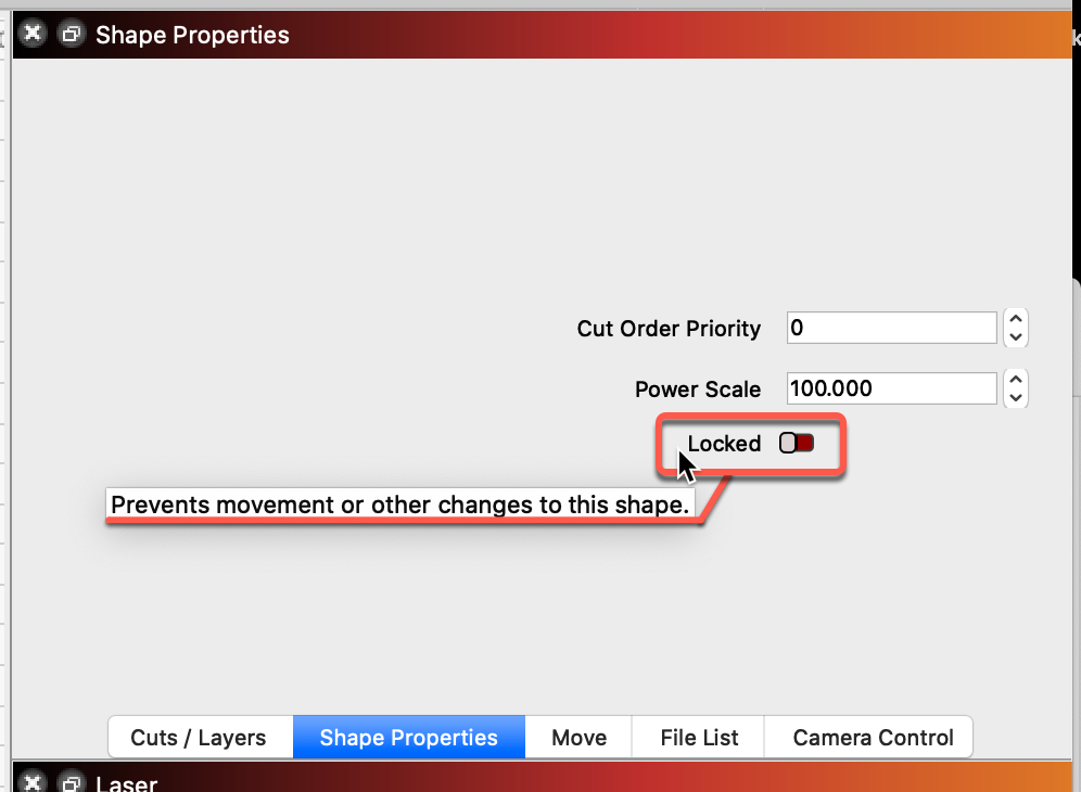

Furthermore, accessible on the ‘Shape Properties’ page.
And from the Main Menu.

I hope that gets you what you need. Your use of the word “tool path” is throwing me off a bit so sounds like it might address what you’re describing but not certain.
In any case, this option basically makes the locked shapes immovable in the workspace.
Interesting. Once he found LightBurn, @richfaraone (The Louisiana Hobby Guy) has been all over each release with a fine toothed comb, so odd - he may have missed that we added this feature back with the release of LightBurn 0.9.12, May 31, 2020. ![]()
Shape Locking
Shapes can now be locked in the workspace to prevent them from being accidentally moved. You can lock from the Shape Properties, Arrange menu, or right-click. Locked shapes cannot be moved or edited without unlocking first.

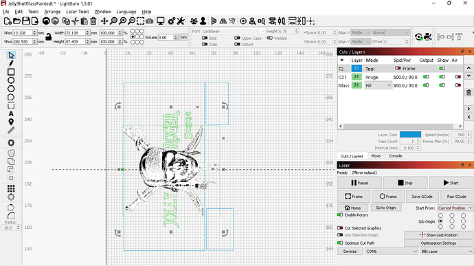

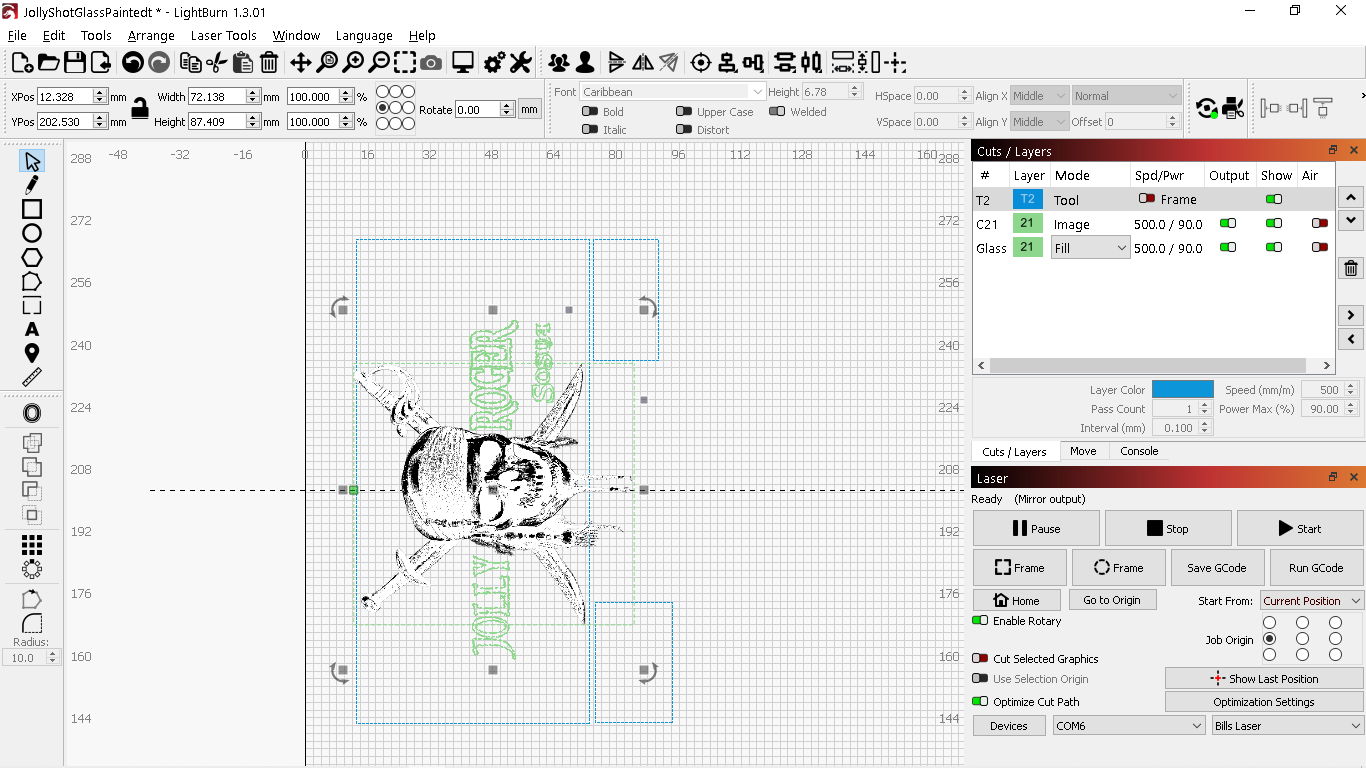

So i hope your suggestion works < the blue line around the art work needs to never move , i drag many images in and out and some times need so make small changes. I have grabbed the image and some times it catches the blue ( box ) line that is my tool path and also my guide line on a very small room for forgiveness , i have had a few times it moves it by mistake and ruin a piece not noticing and having to correct it . Was not aware we could share screen shots or i would not have blathered on in text .

It sounds like your goal is to have the blue tool layer immovable in which case the Shape Locking that Rick pointed out will do exactly what you’re looking for.
By the way, when you initially said tool path I interpreted that to mean the calculated path taken by the laser to complete the job which confused me.
If you ‘Lock’ the selection, you are no longer going to pick the locked shape and move it or change it by mistake. It is locked, so you can not take action on that shape(s) until they are unlocked and made ready for editing again.
Please explain your use of these words. What do you mean when you say your “tool path”? To me, the blue rectangles are being used as layout marks or alignment helpers. They are placed on one of the Tool Layers, which are different from the rest of the layers (marked as T1 and T2 far right in color palette).
Yes sorry the blue lines are T1 or T2 and i wanted them to be non movable. I think you have solved the problem. By the descriptions given it should do exactly what i wanted . I cannot believe how fast and helpful everyone is on this forum . Thank you all
