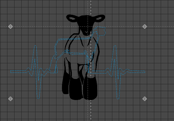

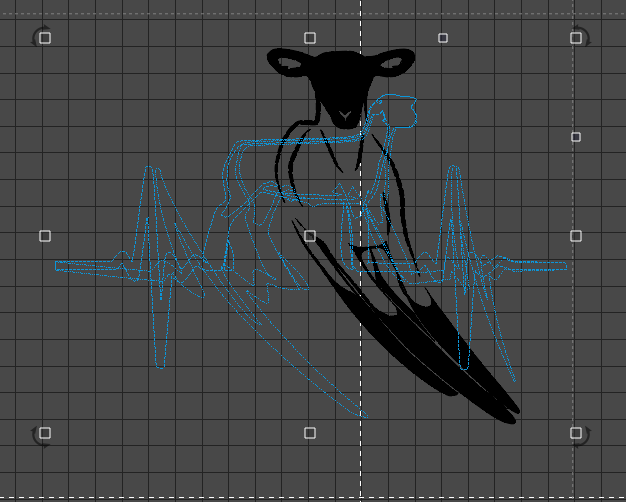

I have a tool layer locked with some shapes on another layer, when trying to 16 point select and deform the shapes the tool layer is duplicating and this copy is deforming with the shape, is this supposed to happen?

So it duplicates the locked shape (shape and text are locked) and deforms the unlocked duplicate along with the shape i want to deform, is this a “Feature” that is anything other than annoying? i cant think of a reason to want to deform a locked shape?

CONFIRMED and discovered: Tool layer will deform AND creates a duplicate copy when both are selected.
SOLUTION - hide the tool layer before you select the layer to deform, then you can turn tool layer back on if needed to guide the deform.

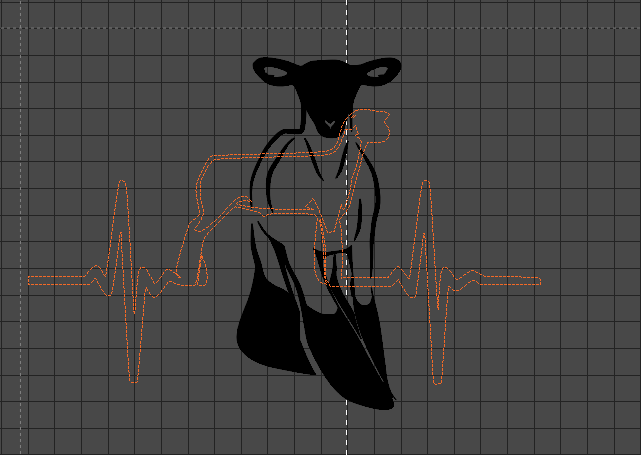

The duplication issue is what the developers need to see. The original locked tool layer remains unchanged.

The good thing is that it creates a duplicate, and the locked shape does stay locked.

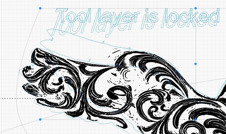

I have a lot of individual shapes making up engraved scroll work I want to fit into the tool layer shape, it’s easier to drag a bounding box around different sections to deform them and have the guide visible to fit into the shape, I’ll just have to live with the duplicated guide being there but it will then create another copy as soon as I bounding box select another section.
