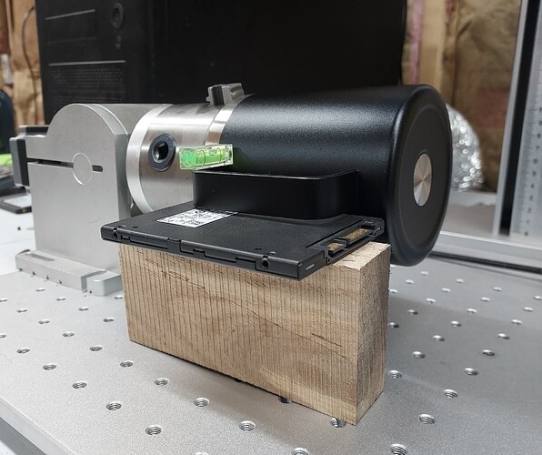

Got my powder coated cups in this week. Haven’t burned one yet. Still trying to decide where to put the logo’s
I’m sure its more of a personal taste thing, but where do most folks place it. 180 degrees opposite of the handle? If holding the cup in your right hand, would you place it out in front of that right hand?
What I’m not sure about is where within light burn do I place the logo, or does it matter, as long as it’s in the working area for that lens? It should be similar to my tumblers I figure. Maybe I’m over thinking it. I have done a measurement yet on the size of the cups for my Steps per Rotation config either. This will be the 2nd time I’ve had to figure that out. All I’ve done with my laser with drinkware are my standard 20oz tumblers.
Rigging up a stop…
My cup is 87.7 in diameter. Pretty much like my tumblers that I have and use … I don’t think I’ll have to setup anything new on the rotary settings.

Why not try printing to a sticker or piece of paper that would allow you to relocate on the cup at various positions. This way you could try it out before committing to a burn.
Looking at my coffee cups, it seems the most common is to have the art facing away from me while the handle is in my right hand. They varied from somewere between 90-ish to 120-ish degrees from the handle.
Looking at novelty mugs online, it seems “away from drinker” is most common, however it was both left-hand and right-hand.
I’d say it depends on the intent. You want the drinker to see the art or show off the art? Spirit lifting humor on a a lonely sunday morning or office space advertising?
I don’t think there’s a wrong answer.
That’s how I do mine. Center of the artwork opposite handle…
It’s a personal thing.
I use wide black masking tape on the mug and low poer to check placement before doing the job.
I’ve always look at it this way. If you have a logo on a mug, you would obviously want it facing away from you so that everyone else can see it. If you’re advertising a business, etc. you want everyone else to see it, not you. You can look at the design on the mug anytime you want, so face it so everyone else can see it too.

Yeah, I think I’m going to start off with having the logo’s burned on the opposing side of the right handed user.
