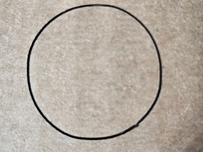

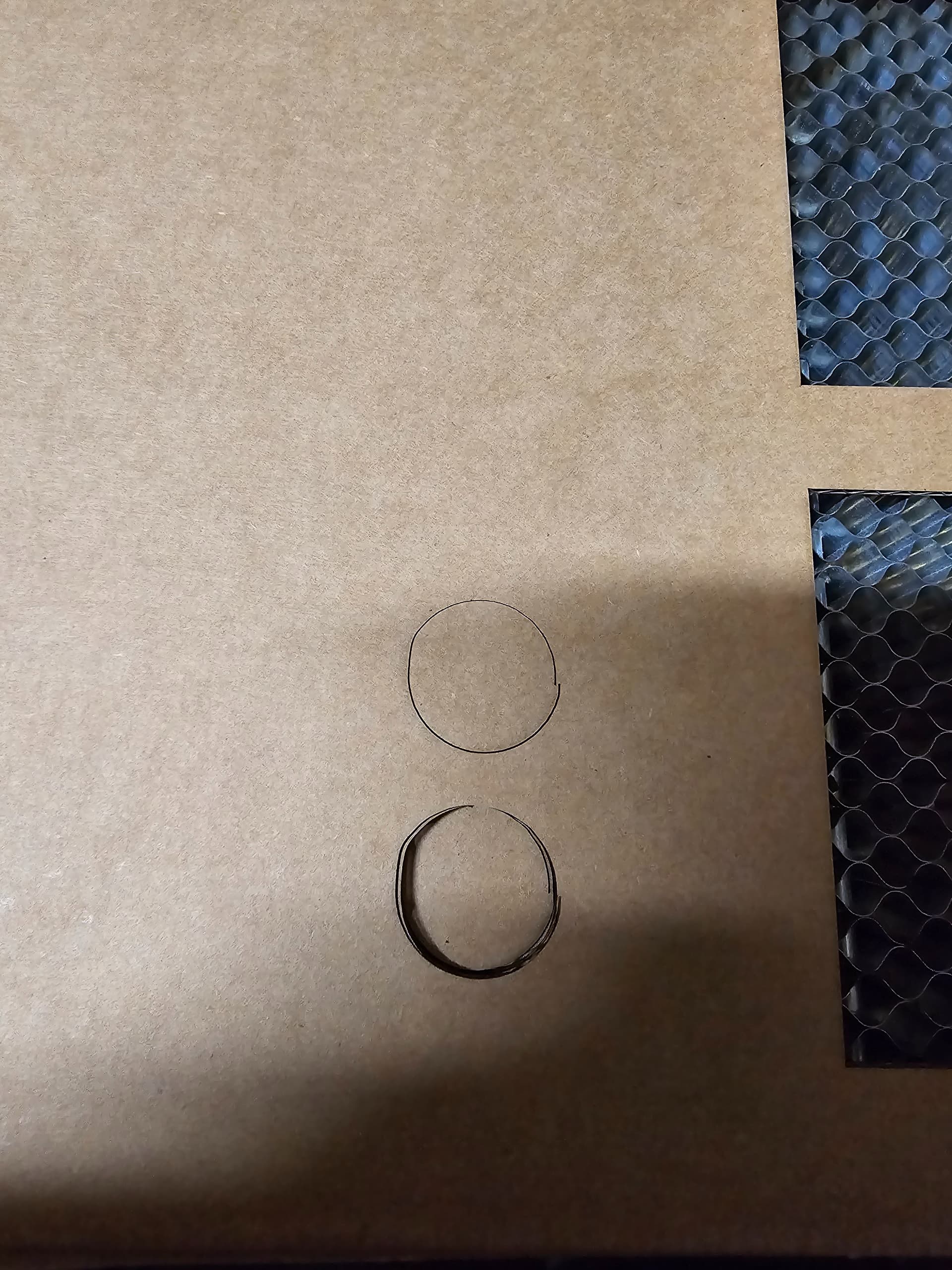

Can anyone who has a Longer B1-30 or B1-40 with the extension kit share their machine and device settings file? I need a good baseline to make sure mine is working properly. When I installed the new machine I had to reverse the x and y homing settings. I got past that so it now does the homing. But I have an issue where it will not create a perfect circle. I have flashed the firmware and was given a settings file from the manufacturer but I do not know how to install the settings from the .nc file. I am hoping I can compare it to someone’s real-world usage. I am hoping it’s just some setting I need to adjust Cutting the circle was worse but I adjusted the tension on the belts and it’s better. It just has a little clip now.

What i can see on your circle is, assuming i got Y X correct your belts are loosee!

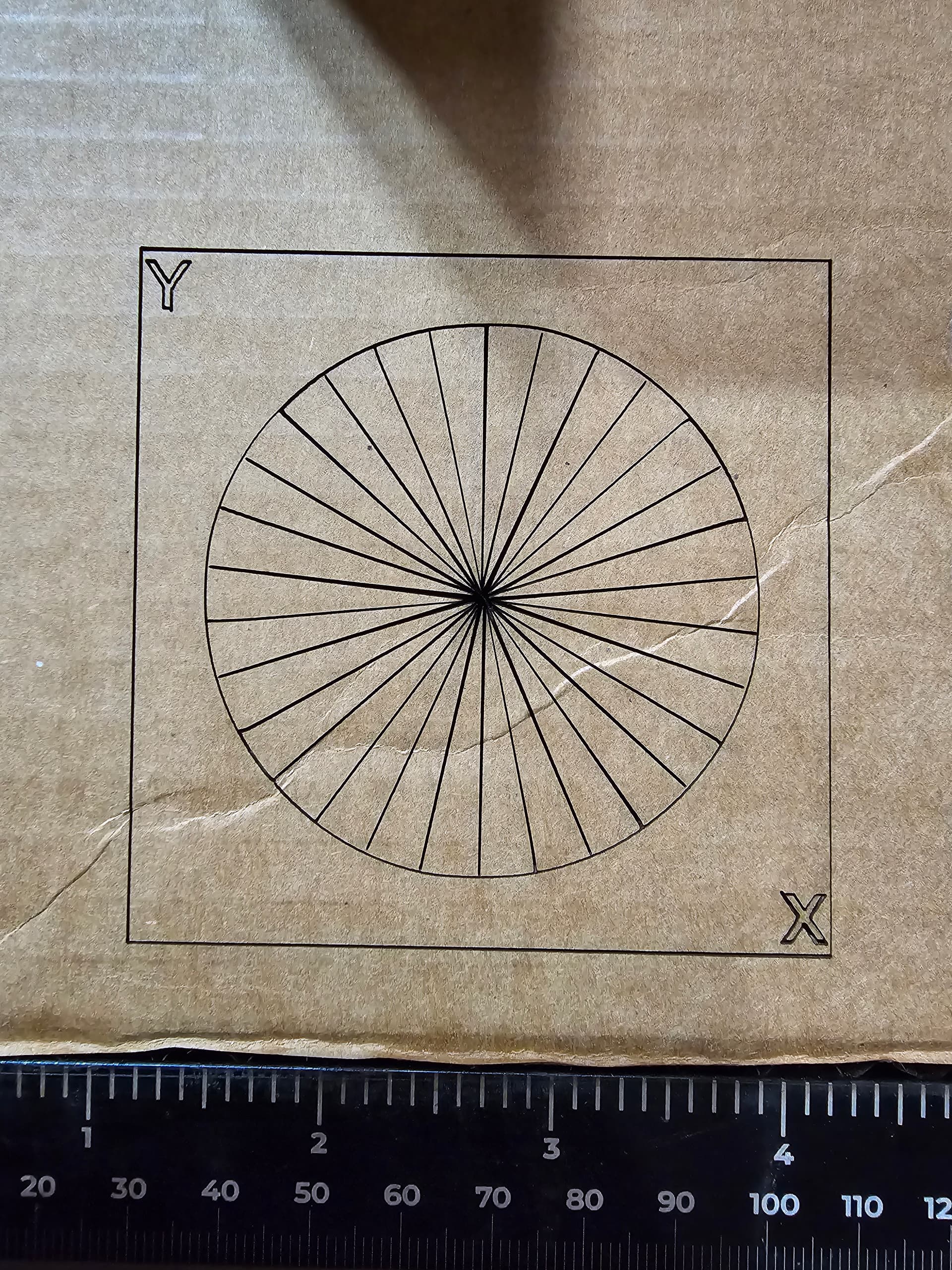

Visual reference below and a test file that will expose any issues
Dot Test with Angle.lbrn (46.3 KB)
Belts
Compare your belts to the above
Also run the test file in a bit of cardboard or wood and take a upclose image and send please?
Here are the results. I also tightened the belts a bit more and the concentric nuts.
No adjustments

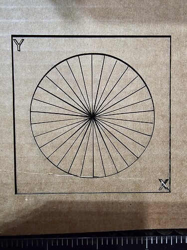

Switched the layer order…spiral pattern first
New circle
Thanks again
I think you need to check your X belts and or sproket
Notice a bit of flatness on left/right side of yoru Circle
you might want to look at the Y on the design too.
But your Y need a bit more too or the axis is not square
You are NEARLY there 90% though
However all compounding in big designs you get those offsets
Try tightening X a bit more and repeat, 1 axis at a time

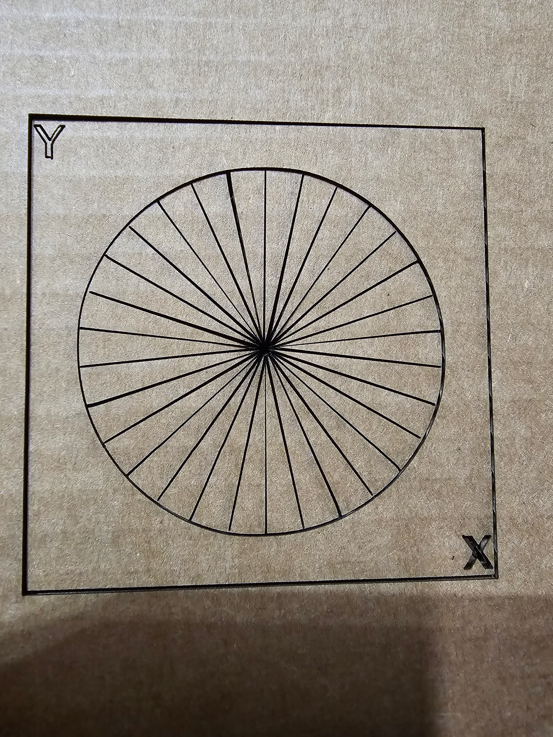

Here is the updated picture after more adjustments…
Looks significantly better
let me ask though
is the square, if you measure it with a ruller, a square?
looks Y is elongaged
Any chance you have Rotary enabled?
Enable Rotary is not enabled. I think the frame is not square. This design is flawed to me in that there are only two screws at each corner. Four would have been better. The square measures 75.5mm x 75.7mm . Great eye!
Should this be cutting out the parts or just scoring them?
Just scoring
Is a belt tensioner test
0.2mm is not too bad looked more
What i would say is try doing some engraving. revisit belt tension in a week or so as they tend to settle
If test is as above you should be ok for 99% of precision yo might need

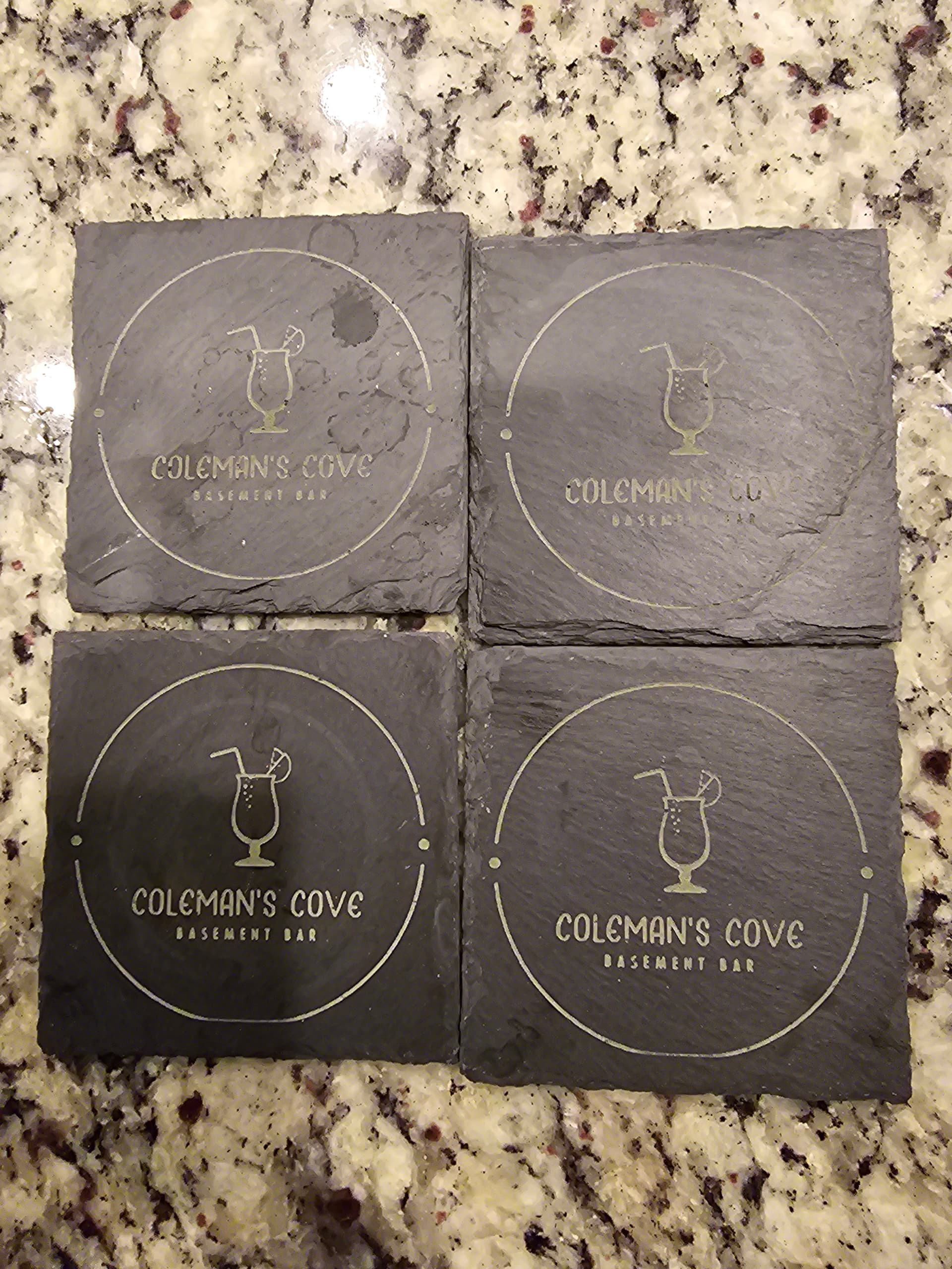

LOL OK…ive been picking up these little pie pieces every time like this test is a lot to clean up…LOL. I was able to make these coasters before I flashed the firmware but now I notice the bottom two do not have perfect circles. This was from an image and when the belts were super loose.
The top ones do feel quite perfect structure wise!
