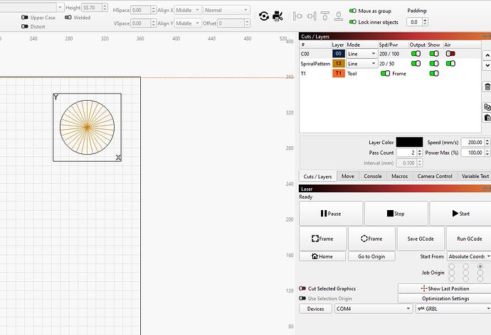

I just set up my laser and have been trying to do test cuts but laser wont cut through 3mm basswood or cardboard. I’ve been playing with the speed/power settings but I just can’t figure it out.

I assume you have it set to mm/m for speed settings.
200mm/m @ 100% power suggests you are cutting in a single pass.
Try 800mm/m @ 80% power and 5 passes.
My 3mm ply cuts through in 3-5 passes depending on when I buy it and what day of the week it is. In other words, it is all over the place, but 5 passes with my 10w gets it every time and charring is minimal.
@bernd.dk is not kidding here.

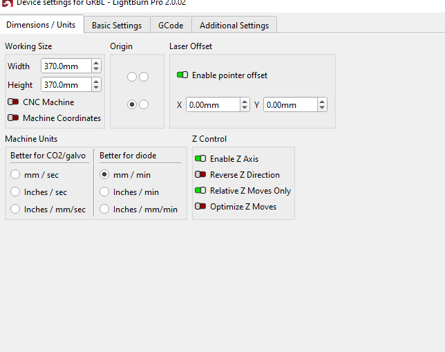

No, she has set it to mm/s. So that’s most likely the issue. @akulisky You need to change the speed units to mm/min in device settings.
I set it to MM/M, thank you. It still didn’t cut the pattern however. It did engrave it so that’s an improvement.

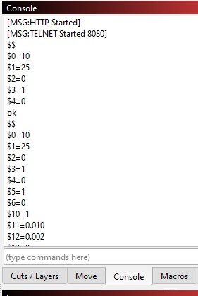

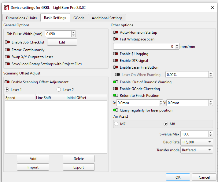

  1. Your S-value Max should be 1000. (Device Settings window in v1.7, Laser Tools window, Device Settings tab in v2.0)
  2. Your GRBL $30 parameter should match ($30=1000). To view, enter $$ in the Console window to view the parameters.
  3. Your Device type should be GRBL (only) with no other letters or numbers.
Let us know if any of this solved your “low power” problem.
Thanks for replying! My S-value max = 1000, $30=1000, and the device type is GBRL. I’m going to run a test and post a pic of the results.

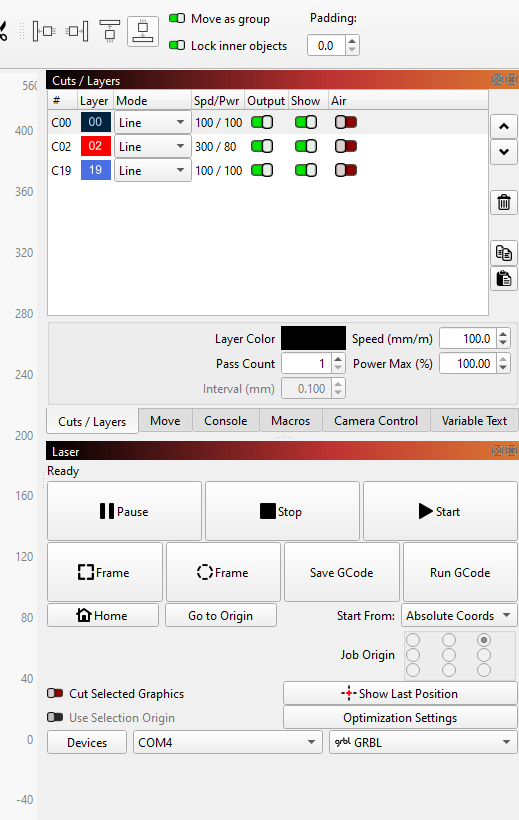

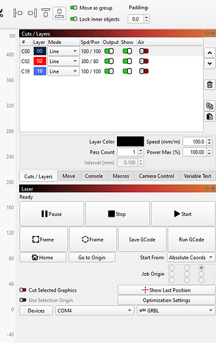

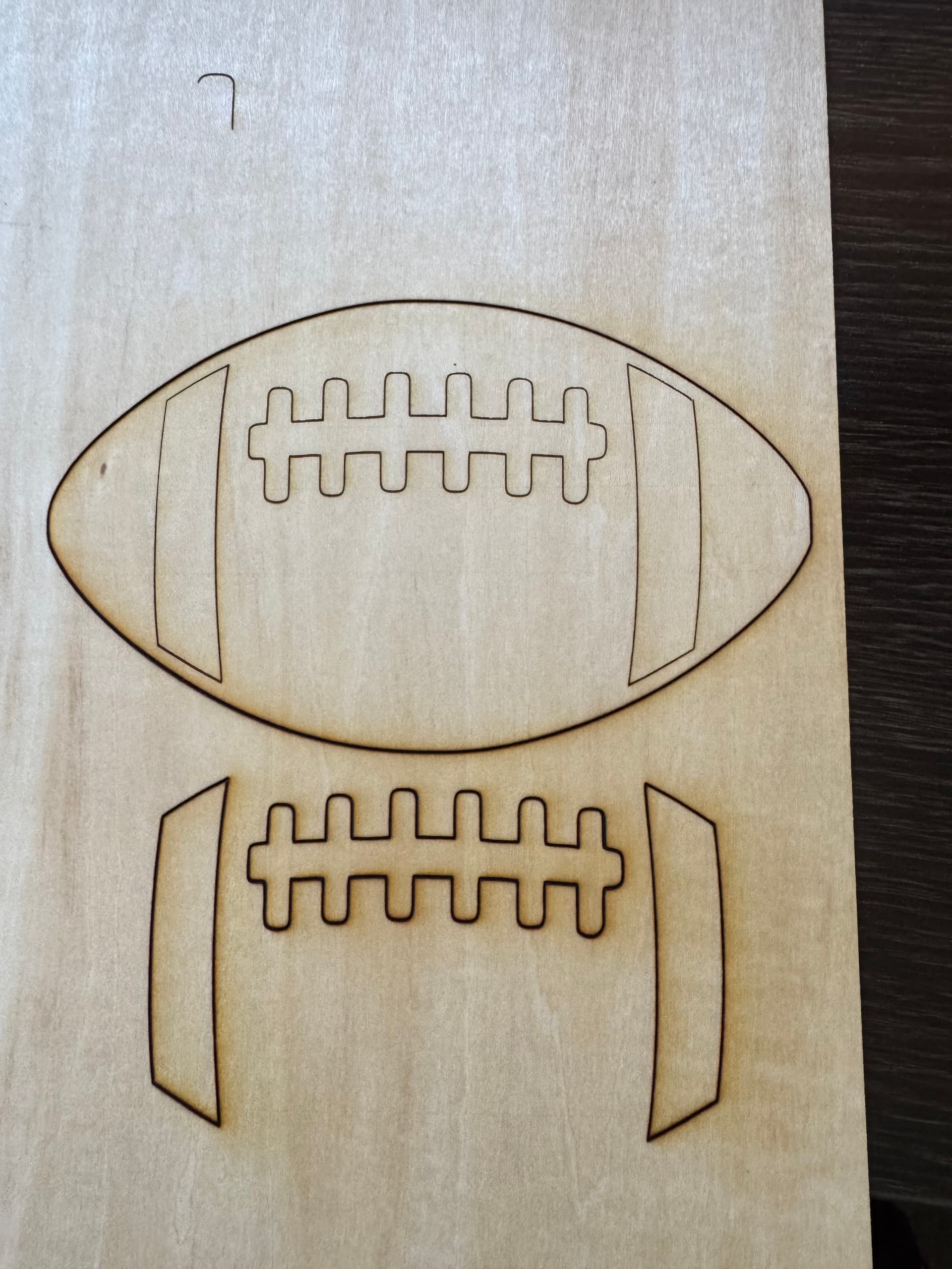

Thanks for replying, I attached a pic of a test as well as the settings I had it on. The cut only went about 1mm deep. Thanks!

I noticed you have Air Assist turned off. Do you have air assist for your machine? It makes a huge difference when cutting.
Cutting in 1 pass is for sales demos. Use 4-5 passes and a higher speed for 3mm Baltic Birch plywood. You will find there is less charing when cutting. Other woods and MDF need even more passes.
Air assist, more passes, and critical focus will get you in business.

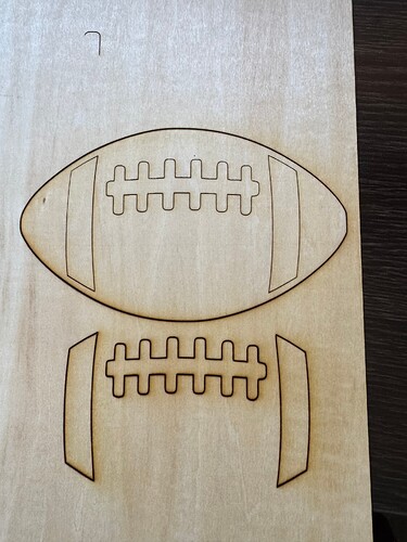

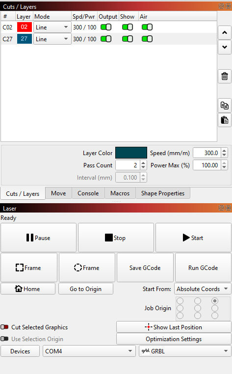

No, I haven’t been able to cut through it at all. I just got done testing a cut and I’m not sure where to go from here. I cut the pattern at 300 mm/min, at 100% power, and 7 passes. I think it may have gone maybe 1/3 of the way through, but there wasn’t a single mark on the backside.
The listing for the wood says it’s 3mm basswood. I wasn’t able to set up the air assist due to needing a nozzle, but I do have a honeycomb layer I used for this last test. I forgot I had it.

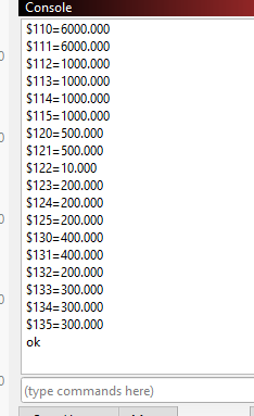

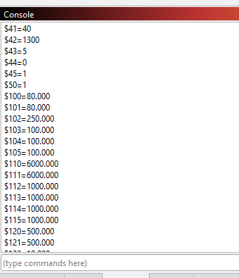

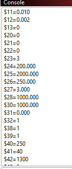

@MikeyH has been into it before, couldn’t you send your $$ settings, the whole thing? , the GRBL experts might be interested in that.
absolutely! Here’s what I ran the last test with
