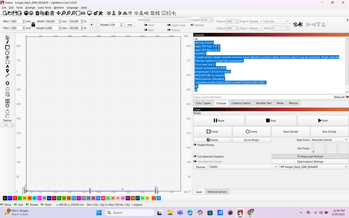

I added the 850x850 extension kit to my Longer Ray5 20W. I’m trying to burn two straight lines, one down the X-axis, the other down the Y.
The Y-axis line burned without issue. When I try to burn the X-axis line, I get the following:
Starting stream
Layer C01 Pass 1 of 2
Layer C01 Pass 2 of 2
ALARM:2
G-code motion target exceeds machine travel. Machine position safely retained. Alarm may be unlocked. (Right-click the ‘Devices’ button to reset the connection)
On or near line 1:
Stream completed in 0:00
SimpleLaser 1.1h [‘$’ for help]
[MSG:‘$H’|‘$X’ to unlock]
[MSG:Caution: Unlocked]
<Idle|MPos:0.000,0.000,0.000|FS:0,0|WCO:0.000,0.000,0.000>
ok

Because of the laser head, you may not be getting full travel. You got lucky on the Yaxis. Reduce the travel range on the Xaxis maybe 10mm and try that.
Go to Edit Machine Settings and look up your machine settings. Your machine settings in the firmware may need to be adjusted to the new 850 x 850 value. Looks like lightburn is set correctly
Under Output Setup your looking for $130 and $131.
If everything on the firmware looks good do what the gentleman above said on the X axis
