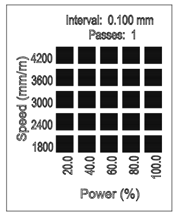

I have a Longer Ray5 10w laser and recently bought the longer rotary attachment. I adjusted the settings as follows:
I tried running a material test, which should look like this:
but for some reason, the image is skewing/drifting as it moves up the y-axis like this:
Can anyone help me? It’s driving me crazy!
How big are the squares?
At 500mm/s^2 acceleration, it will take almost 5mm to reach 70mm/s (4200mm/m). So it’s likely you are not getting to the speed you have selected.
More than likely this acceleration value might be part of the issue… I have my Y acceleration down in the single digits at times to keep the object from slipping when using my roller rotary. That’s what it looks like anyway.
