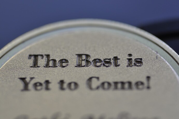

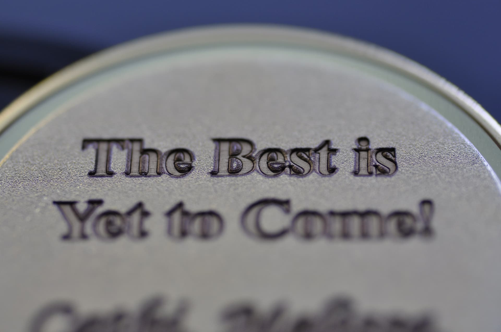

Look at difference, what setting is this?
Can anyone take a look at the two images and tell me what setting makes this kind of difference in the letter. I want the effect in Image A as it looks better than the B effect.
What did I do different? Nothing except update LightBurn which appeared to trash my settings and now I cannot produce the same quality effect.
Image A: Desired! Nice crisp edges, notice the bowl shape of the actual letter:
Image B: Not desired. The bottom of the letters are flat and clean, but the ramping on the sides is not visually appealing.
