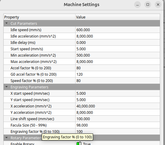

How does the Ruida know if it’s a cut or not? By the line/dither information?
I’d seen an RDWorks screenshot that appears to have a toggle for a cut/engrave.
:grinning_cat:
It doesn’t have any idea if it’s a cut - it’s “Line” or “Fill”. Line means “follow the line” and Fill means “scan between the lines”. The difference between cutting or not is a function of power and speed, and will depend on your machine.
The Ruida, at least mine, has a section for cutting and a section for engraving. How do these get selected? Or which is used where and how does it (the Ruida) know which mode it’s using?
The machine settings have both engrave and cut sections.

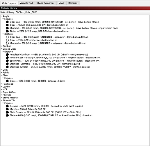

This as a reference has worked an absolute treat! Thank you, Oz!
There is some obvious robot use, but I did not do so lazily. I tested all of the bits it threw in here, some multiple ways, and where I wasn’t able to I tried to note that. In my case there was not a use for each and every entry, so on the template you’ll only see notes on the ones I modified for my use.
CLB_TEMPLATE.clb (10.9 KB)
Building or Rebuilding a LightBurn Material Library by hand
How to use TEMPLATE.clb. Written while rebuilding a lost library for an OMTech
Polar 50W (Ruida CO2), but only the sections marked Machine are specific
to that.
Everything here was verified against, in descending order of authority:
  1. LightBurn’s CUT_PARAMS struct, published by Oz
  2. A .clb re-saved by LightBurn itself to verify what it reads and writes
  3. Two third-party libraries: Thunder Laser Mini 40W, and WAZER (744 total entries)
  4. The LightBurn 2.1 Material Library documentation
Where something is not verified, I tried to mention it. That said, do not trust anything in here
as I did involve an LLM for clarity and formatting. I used it, but that doesn’t mean you should.

Everything is <tag Value="..."/>.
Hierarchy
LightBurnLibrary            DisplayName = dropdown label
  Material   @name          top folder          "Acrylic"
    Entry    @Thickness     sub-folder          "3.00mm"
             @NoThickTitle  sub-folder INSTEAD, when Thickness = -1.0000
             @Desc          the entry's label in the list
      CutSetting @type      "Cut" or "Scan"
Thickness and NoThickTitle are the same slot in the tree.
LightBurn greys out the Title box when a thickness is set, and greys out
Thickness when you toggle No Thickness on.
You want You write
Sub-folder reads 3.00mm Thickness="3.0000", no NoThickTitle
Sub-folder reads Cut Thickness="-1.0000" NoThickTitle="Cut"
Use a positive thickness when it makes sense, i.e. cuts.
Use -1.0000 plus a title for surface operations that don’t care how
thick the material is. It keeps engraves
from cluttering your thickness folders.
Group by family
Put the family in Material @name and the variant in Desc:
Plywood
  3.00mm  → Baltic Birch - 72% @ 18 mm/s
  6.00mm  → Baltic Birch - 88% @ 8 mm/s, x2
  Cut     → Plywood - 70% @ 15 mm/s        (thickness unknown)
  Engrave → Baltic Birch - 22% @ 350 mm/s, 254 DPI
One Material per "3mm Baltic Birch Plywood" gives you forty top-level
folders and no way to compare thicknesses side by side.
Putting the headline numbers in Desc makes contradictory
entries visible without opening anything, i.e., Slate - 60% sitting directly above
Slate Coaster - 28%.
Heats & Feeds

When saving
It rewrites the file sparsely. In a measured round trip it kept 9 fields and
dropped about 39. It keeps index, name, LinkPath, minPower, maxPower,
maxPower2, speed, priority, plus anything where the value differs from
CUT_PARAMS default.
Omitting a field is identical to writing its default. So you can write the
full 48-field block for a human-readable file, or only your non-defaults to
match what LightBurn produces. Both load the same. Entry 1 in the template is
the long form; entries 2 and 3 are the short form.
LightBurn also adds two items on save:
  • DisplayName on the root.
  • LinkPath per CutSetting, as Material/Thickness/Desc.
The template omits LinkPath on purpose. That format is confirmed only for
entries with a thickness; the no-thickness form is unverified, and entering a wrong
value might break Link. LightBurn regenerates it on save and it only
affects Link, not Assign, so nothing seems to break without it.

Machine-specific choices in the template
These are the settings specific to my OMTech Polar 50W. I can’t guarantee they’ll work
even for your OMTech Polar 50W, so there are no warranties, guarantees, and any use is
at your own risk.
Field Value Why
speed ceiling 500 mm/s Polar’s rated max speed
frequency 20000 Hz glass tubes don’t care
runBlower 1 The Polar ignores the off setting. Air Assist always runs.
enableLaser2 0 Single tube machine
overscan 0 See below
overscan is the one deliberate shift. CUT_PARAMS defaults it to
1; the template ships 0, following the Ruida-class reference library, the
DSP does its own acceleration ramp outside the image area. If raster edges come
out dark, set it to 1.
