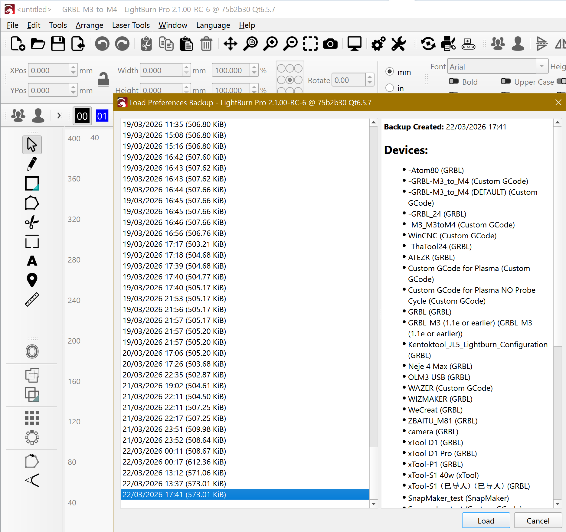

I know that Lightburn has restore points, I found out last year by accident. Now that I am looking for it I cant seem to find it or go about getting to it. I have a Sihao 100 watt co2 that started acting strange lately. When nothing is connected to it, it works fine, as soon as I hook up a usb line it starts dragging and wont do much of anythhing. I know that windows had a update and it might be that but it seems to me that some setting must have changed, hence, looking of the lightburn restore point.

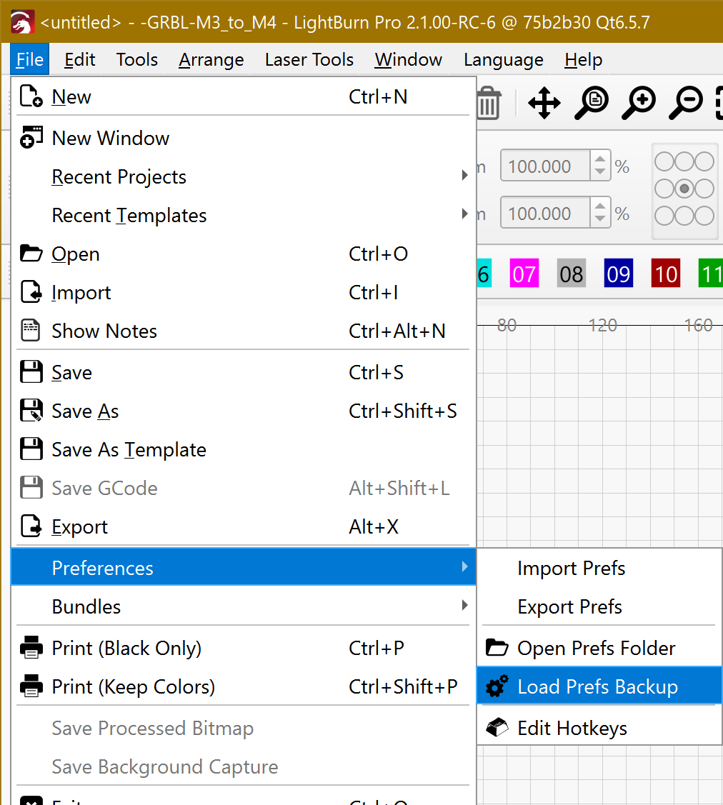

Check here:
And you´ll get similar to this:
Then choose a previous backup prefs file before it´s acting strange.
Here is the Doc:

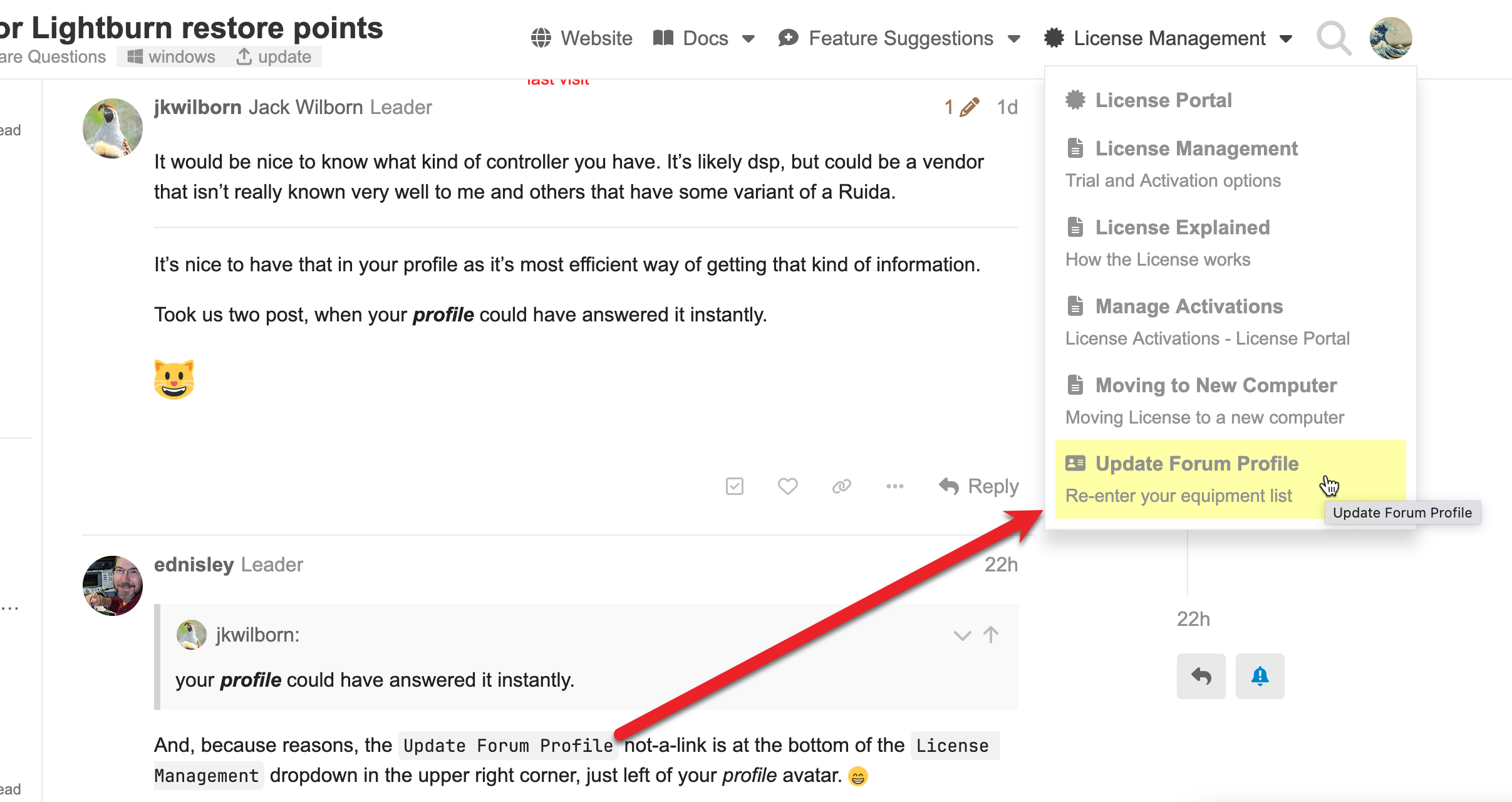

It would be nice to know what kind of controller you have. It’s likely dsp, but could be a vendor that isn’t really known very well to me and others that have some variant of a Ruida.
It’s nice to have that in your profile as it’s most efficient way of getting that kind of information.
Took us two post, when your profile could have answered it instantly.
:grinning_cat:
And, because reasons, the Update Forum Profile not-a-link is at the bottom of the License Management dropdown in the upper right corner, just left of your profile avatar. :grin:
