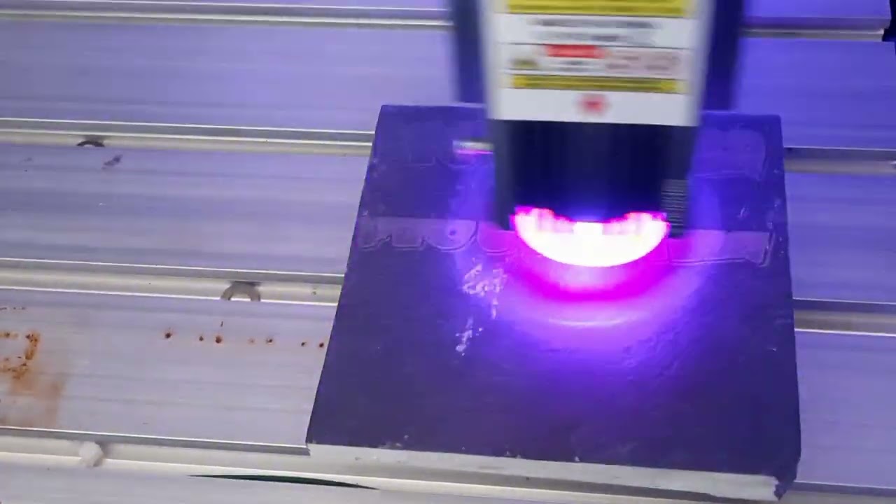

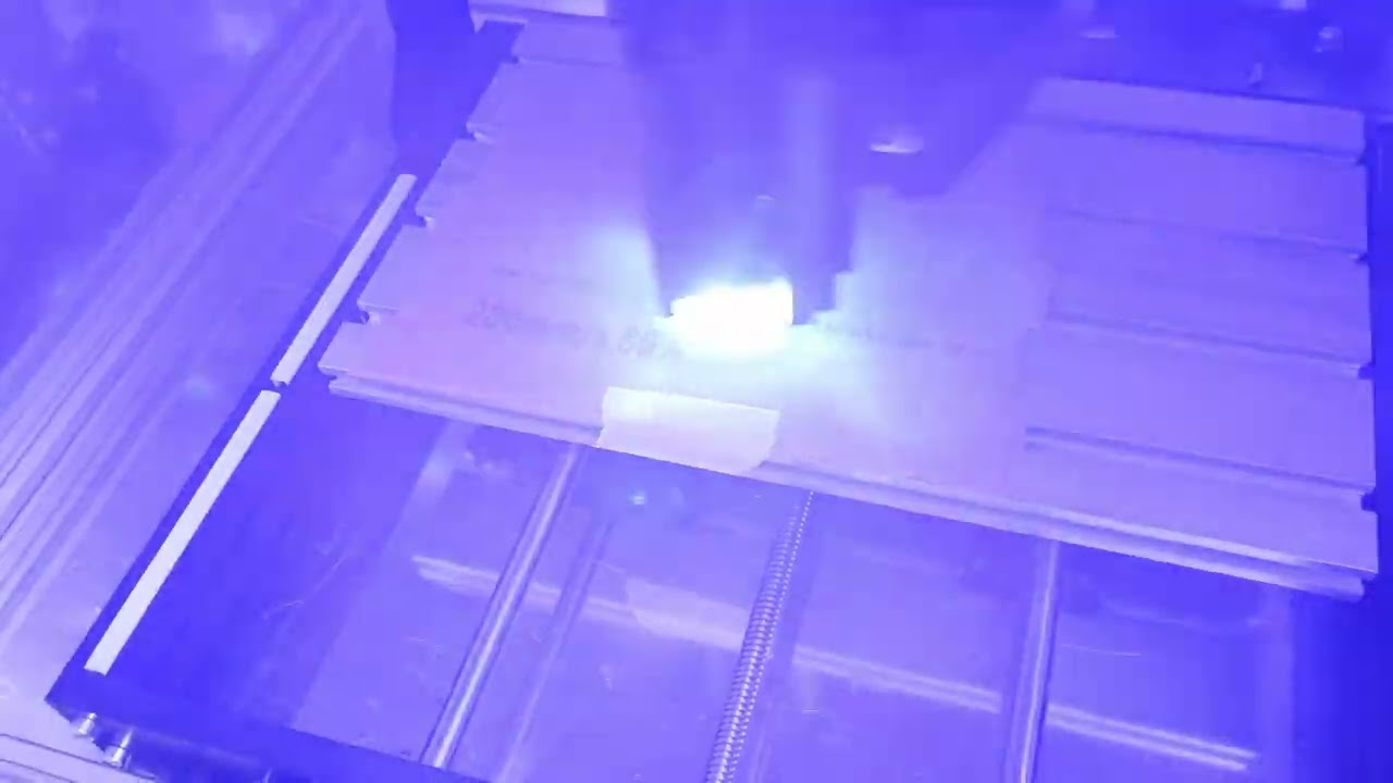

I have a Diode Laser Based on a cheap 3018 China Router running with a Ruida RDC6442 and a Sculpfun S9 Module.
just take a look :

There are two ways to Use a Ruida or other DSP with Diode.
Either put an OR Gate on Laser on and PWM to mix them or simply choose RF Tube Mode without preignition. The former allows you to run a Glass Tube and a Diode in one Machine without reconfiguring everything when switching the laser.
