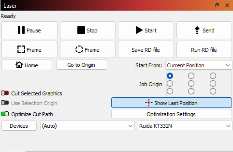

Looking for the Function to Start Milling at current position
I am searching for the function we have in Lightburn to start a job from the current position
Or an explanation on how to set up the CNC to start at that given position on my Vevor 4040 it feels like he hes randomly moving to diffrent places to start

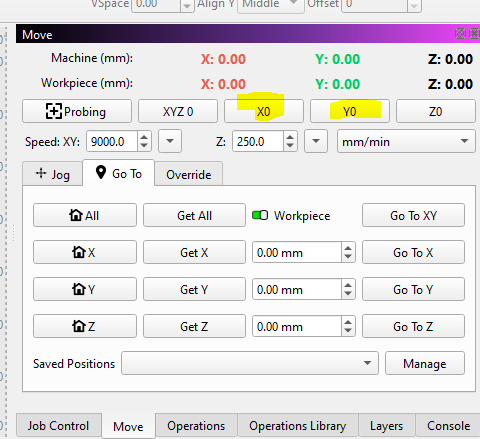

move tool to where you want with jog or type in corridenents click on table X0 YO,
do a few dry runs 1st, as it takes a bit of getting use to as it shifts work area and can run past axis if not careful

so i will use my 150 x 150mm piece use one corner as the “reference home” an zero X & Y.
But if i do that the maschine still tries to move across the full maschienes working area for some reason
Upload the .mage file that does this. Also enter $$ in the Console window and copy-paste everything after the $$ in the display window.
Home = A machine position, set with limit switches, and cannot be moved. Automatically sets Origin to 0,0 position.
Origin = A software 0,0 position that can be anywhere. Requires a good understanding of machine limits and coordinate systems.

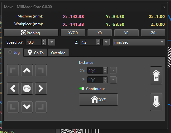

i have a vevor 4040
when i home the maschine it goes to the limit switches thats fine
but when i frame the workpiece i have a large offset even thou the work should start in the center of the maschine. The Framing looks good at first glance but once i start the maschine it crashed into the Limit switches here is the console:

[G54:18.900,-13.253,-18.022]
G54 Offset values not 0
Machine size mismatch

Did you mess with your machine GRBL settings?
As a start change GRBL $130 $131 and $132 per your machine work area (volume).
not realy i read it from the maschine controller and it just said that the working area was lager then in my project
I think you have a corrdinates issue. Please answer these questions so we can better offer advice.
  1. Where does the spindle go when you Home the machine?
  2. Please describe how you locate your part and set up Lightburn. Please be explicit.
  3. Am I safe assuming this is a traveling table in the Yaxis?
You have a 2020 (200mm x 200mm) machine. But remember, you set up the work area initially with the raw material part size.
If I say anything you already know, that is only because I do not know you know. :grin:
Hi Mikey,
i found my mistake.
I did not proper zero x and y this lead to the wrong alignement of movement.
Thanks for the help you all
