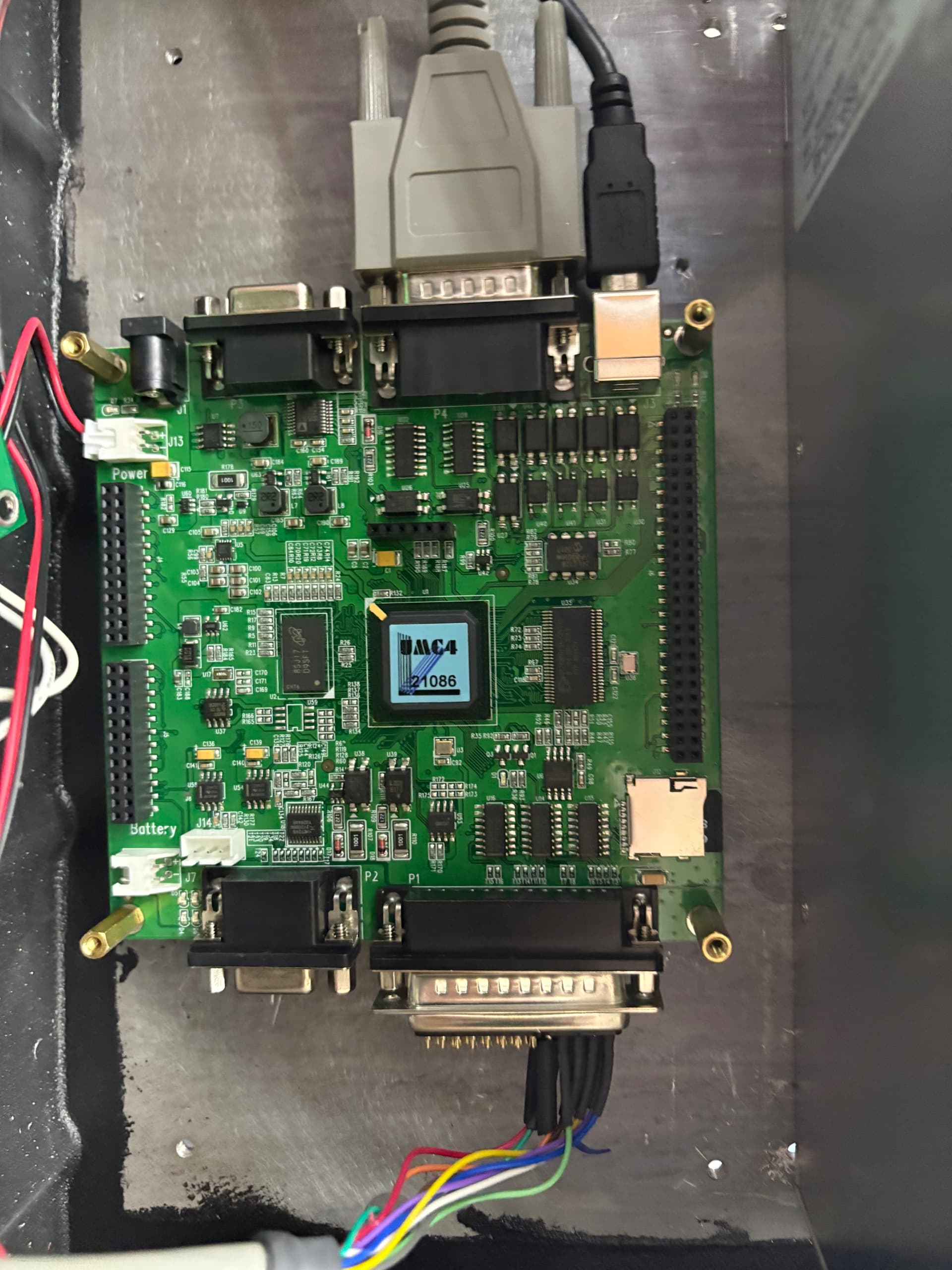

Update: Found the existing driver identifies as UMC4 YAG1. With that I’ve found some compatible controllers via Google. Now, any idea if there’s a way to get Lightburn to work with a UMC4 YAG1 control card?
Unfortunately at this moment the best option would be a control card swap in order to get LightBurn working with your laser. We do have plans for expanding our controller compatibility but we don’t have a timeline for when this will be.

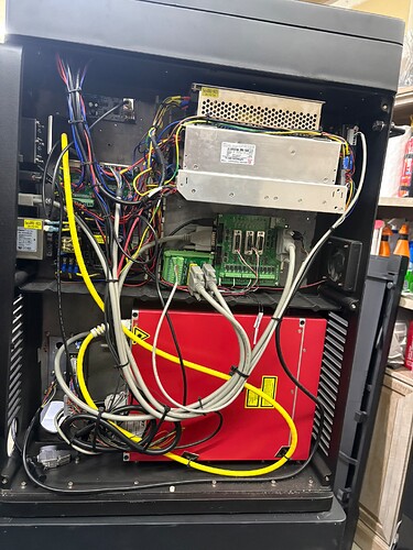

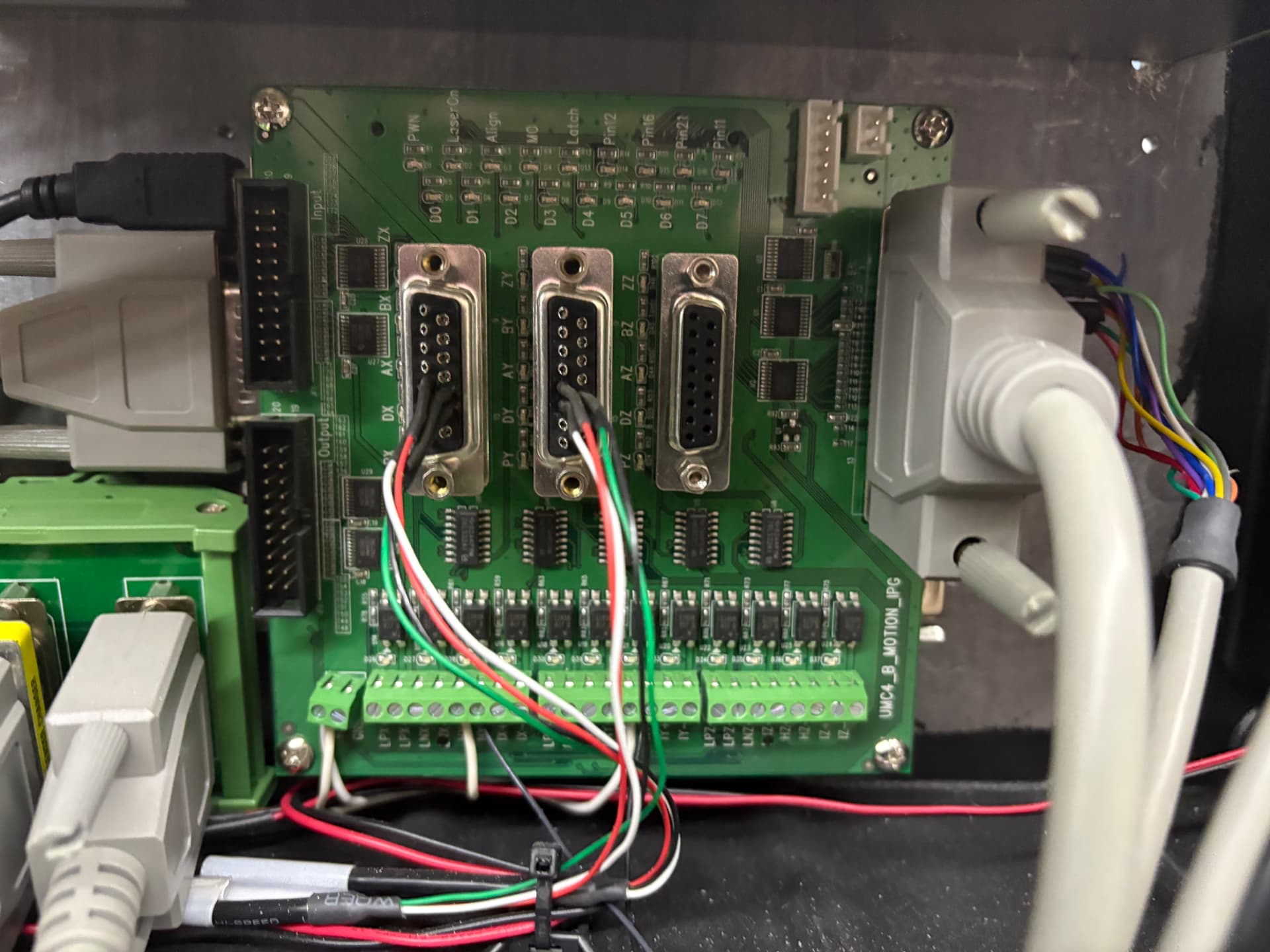

If possible, might post a couple of photos of the control board there is a chance someone could recognize it…

I think all you can do is ensure the proper driver is installed and ensure the os can see the device. Then see if Lightburn can connect. If the os can’t see it, Lightburn can’t connect. Even if the os can see it, it may not work.
Does it look like this?
If it doesn’t, can open it up and post a photo of the control card and source? Then maybe we can figure it out.
Yep that’s the one.
I can only suggest you try and find a different driver. EZCad2 and Lightburn drivers are not compatible, as far as I know.
Generally the software is EZCad2, if it’s not, then it’s isn’t likely that Lightburn going to talk to it. Only the Lightburn people can really answer that.
Worst case, you might wind up swapping out the controller.
