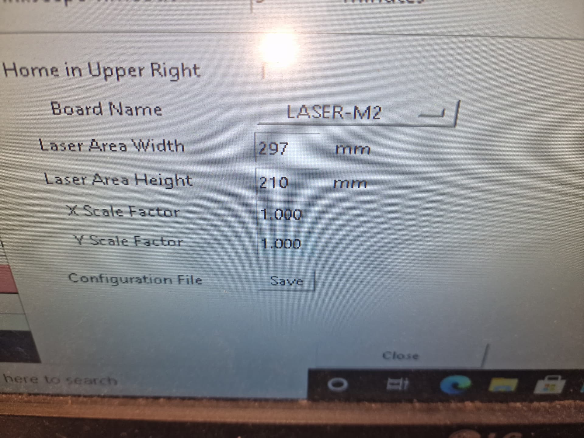

Thank you again for the help but the only settings i can find is from k40 whisper
And i dont think that helps any

Well, it gives you the X and Y sizes, but the useful information tapers off pretty quickly after that.
Perhaps there’s another program shipped with the K40 revealing more detail. Alas, not having any direct experience with that setup, I’m not much use.
