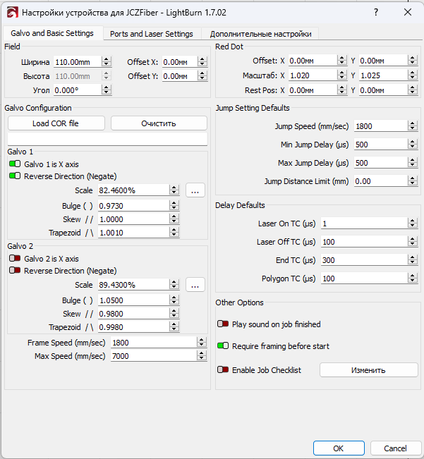

I used EZCAD before. I installed a trial version of lightburn. I imported the settings. But I noticed that the laser power decreased. I switched back to EZCAD. The power was restored. I switched back to lightburn and the power decreased again. Tell me what the problem could be. Thank you.
can you upload a picture of your settings in ezcad and then in LightBurn? also what kind of fiber are you using? jpt, raycus?
Which control board do you use? change “fiber type” to IPG_YLP
JCZFiber
And will this not harm my emitter? I use JPT
control board original?
yes. EZCAD Lite
photo control board?
It will not harm your Galvo, but you should also make sure you’re enabling QPulse if it is a mopa if it’s not a mopa then that’s fine to keep it disabled
