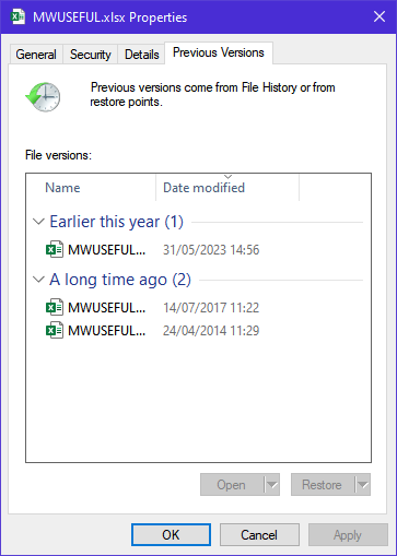

There’s an outside chance that Windows has kept a file history (although I’m not sure it works for files on external drives). Right-click the file in explorer and select ‘Properties’ then select the ‘Previous Versions’ tab, if you’re lucky it might display a list of previous versions of your file something like this:
You can select any of the previous versions listed and either open it or restore it as the latest version.
If file history isn’t turned on you might want to do so (just Google it to find out how). You do however need either an external or network drive for Windows to store the file history.

Nice try Marcus…as you said not with external SD card…
