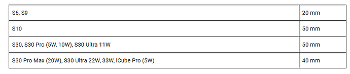

Maybe it’s because I have a 3 year old. Maybe it’s because I’m irresponsible. Alas, i lost my little aluminum cylinder that’s used to measure the distance between the bottom of the laser and the material so that the top face is at the focal point. I know this measurement is different for different lasers, and mine is the Sculpfun S30 pro max 20W laser. I’m asking here for some help. If you have this laser and you have the cylinder, can you please tell me its length? I’ll just burn a piece of wood that length and use it instead. Thank you!

All focus lengths are listed here: Setting up the software - Diode Laser Wiki
Thank you!! 40 mm is the answer. I’ll cut a piece of wood this distance.
