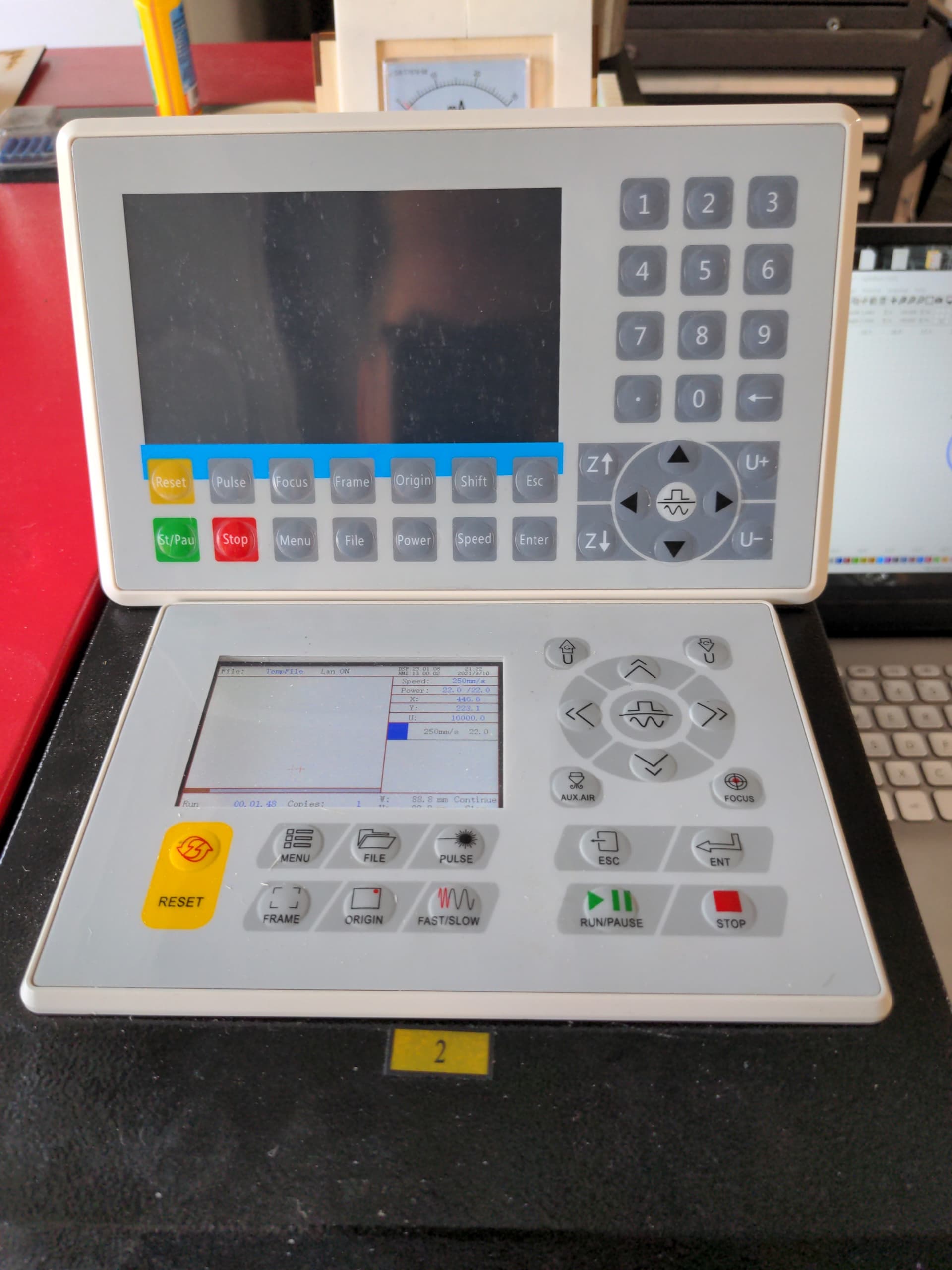

You can go into the menu and check if the rotary in enabled or disabled on the controller. If its enabled disable it and save. Then hit the yellow reset.
This is what I have. I have not installed the top controller yet.
Rotary was off. I used the rest button and the moved the laser head. I closed Lightburn and reopened. Pulled up a new file, added a cut sized 10x10" set at 5s/40p and it says it will be complete in 9 sec. I don’t think that is correct.
My controller is the same as your one connected to the machine.
