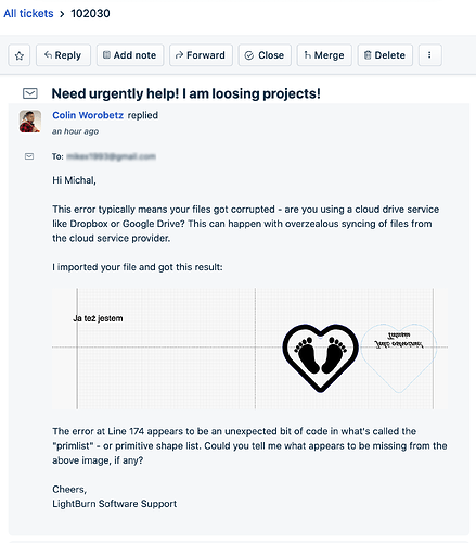

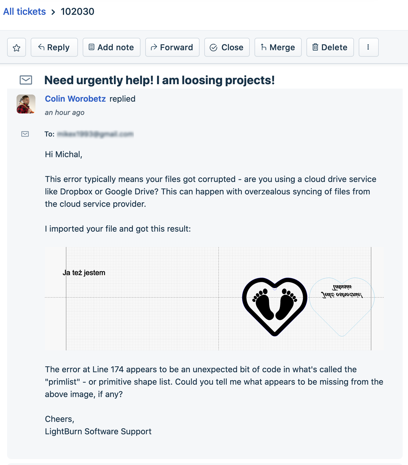

These files are corrupted, yes. I am looking into the construction now. Please explain how you generated each of these and what you were doing when you last saved these. Where do you save these? Local drive or cloud / remote storage?

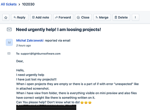

The Robocze 1.lbrn2 file has some content, but corrupted in some spots, producing the message “(line 174?)”. The contents of the Skrzynki Ślubne v4.lbrn2 file does not look to be a LightBurn file. Please tell us as much as you can about this file. How was it generated, what is in it (vector art, raster/bitmap images, both)?
As you gather further information to share with us, I will continue to investigate…

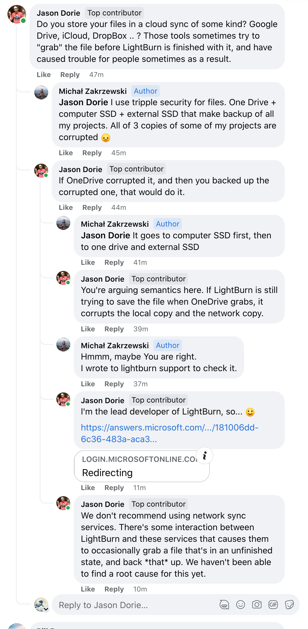

These were my own projects, all had vector graphic.

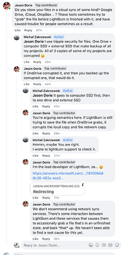

I use tripple security for saving files - Computer SSD + One Drive + external SSD that made copy of my files from SSD.
All 3 sources are corrupted.
What weird happened? Hmmm. During making other project some of LB art library went corrupted. I had to delete this library and make new again.
LB was busy all the time and not responding when i was trying to open grapics library.
I think (but i am not sure) that some of these project had graphics from this art library. But it’s shouldn’t be related.
There is nothing else that comes to my mind.
Don’t worry about these files. I’ve already made new projects.
We need to investigate to avoid further situations.

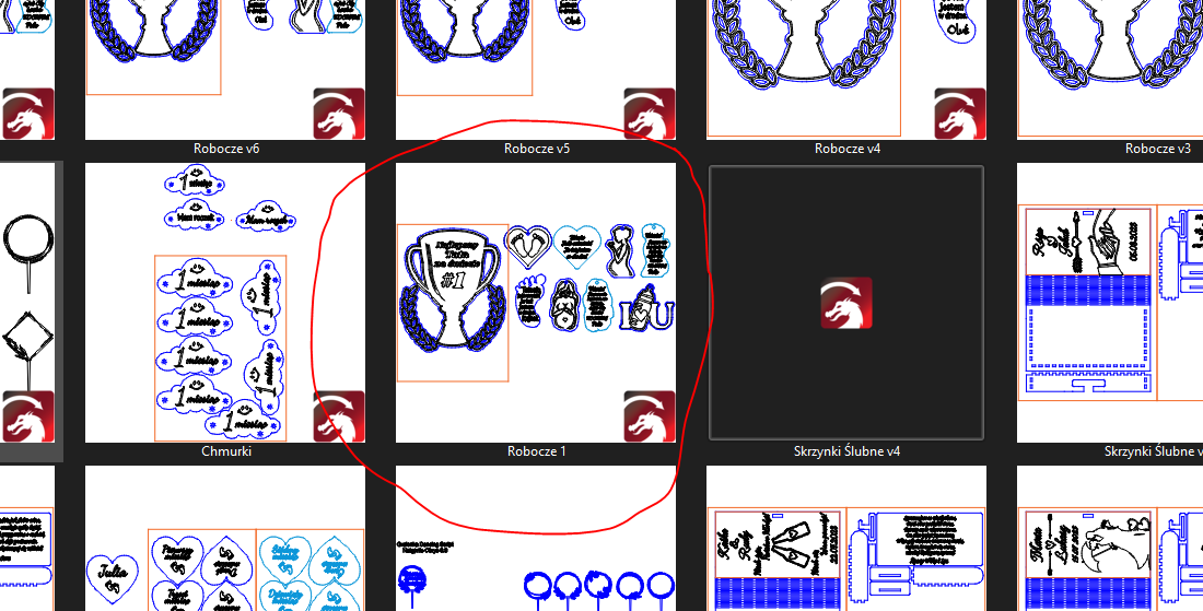

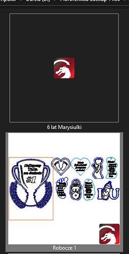

Also that’s weird that i can still see complete project in my folder when i turn big windows.
Like LB can generate small graphic on overview, but cannot load complete project.
