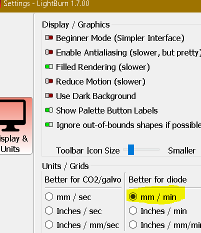

Thanks for your input. Speed settings are set at mm/min…thats not the problem. I have not changed a thing since i started using the Lightburn software. I only updated.

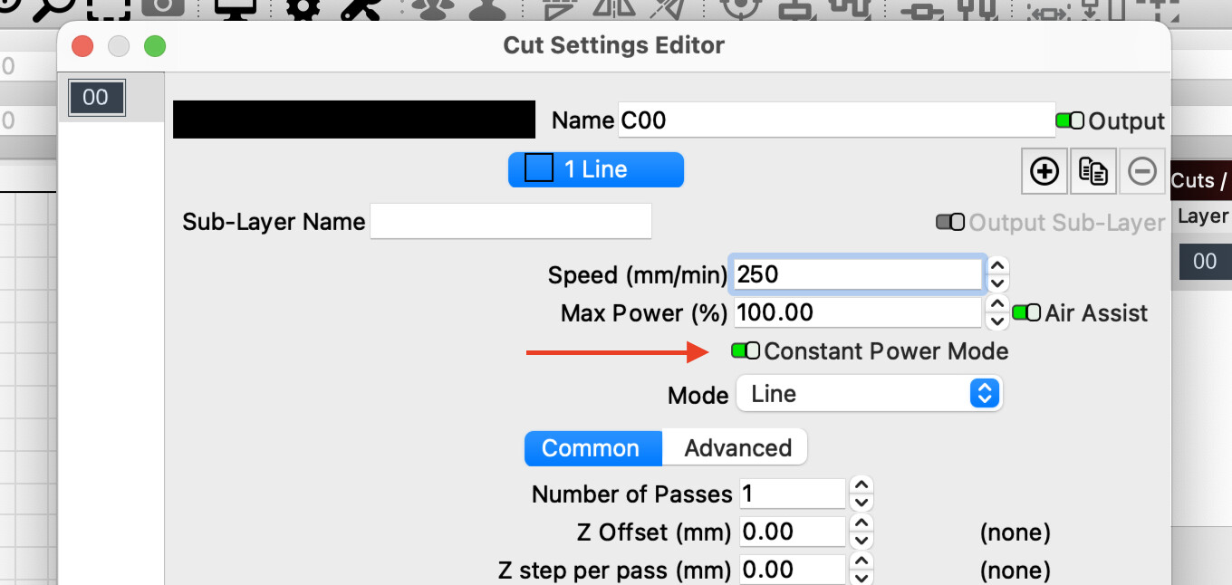

LaserGRBL may be using the M3/Constant Power mode command by default, which means your laser is always outputting at the maximum power you set for a project, regardless of speed. LightBurn uses M4/Variable Power modeby default, which causes power to scale according to speed – starting at 0 when the laser is stopped, and ramping up to the max power you’ve set as it accelerates to the speed you’ve set.
You can enable Constant Power Mode in the Cut Settings Editor, and see if the behavior changes.
If it does, you may need to slow your job down if you want to return to using Variable Power mode (which often yields better results). If you set a project speed in excess of the maximum speed your laser can travel at, it will never reach full power either, when using Variable Power.
Thanks for the reply. I have been trying many different things…“constant power mode” in the layer tab is one of them. I now have it on as standard. Does not make a difference. For example what the problem is. Using LaserGRBL i can cut through 2mm thick leather in 2 passes at speed 500 and 100%power…for the Lightburn software i need 3 passes at 300 speed 100%power for the exact same 2mm leather…it used to be faster than that in Lightburn when i look at the material test i did about 1 year ago.

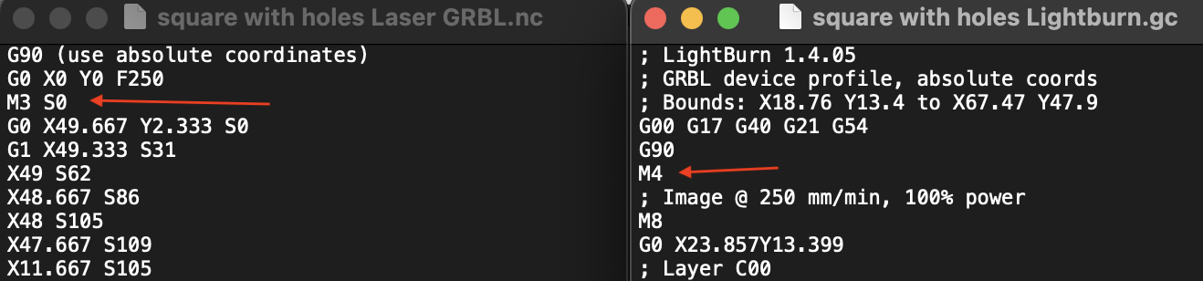

If you can save and share the GCode produced by LaserGRBL versus LightBurn we can compare your settings to identify any differences. In LaserGRBL you just go to File → Save (I believe) and in LightBurn go to File → Save GCode, or click Save GCode in the Laser window.
There are only a few variables could possibly cause a difference in power output between LaserGRBL and LightBurn. Those are Variable/Constant Power mode, Speed, and S-value Max.
I will get to that tomorrow. So lets say i cut a simple square or circle using lightburn and lasergrbl…with the same power and speed…and save both files as gcode and show it via printscreen would that be sufficient??
Yes. It will be best if you upload the files themselves here so we can take a close look, but screenshots will suffice provided they show all the GCode (particularly the information at the start).
Here are both files…its an image because LaserGrbl does not support the DXF files i normally use. square with holes Laser GRBL.nc (24,7 KB)
square with holes Lightburn.gc (21,5 KB)
Both have the same settings 1 pass at 100% and 250mm/min. The image is the same size.
Laser GRBL cuts trough completely…Lightburn barely halfway to the 2mm thick leather.
You are using Constant Power (M3) mode with LaserGRBL, but Variable Power (M4) mode with LightBurn.
