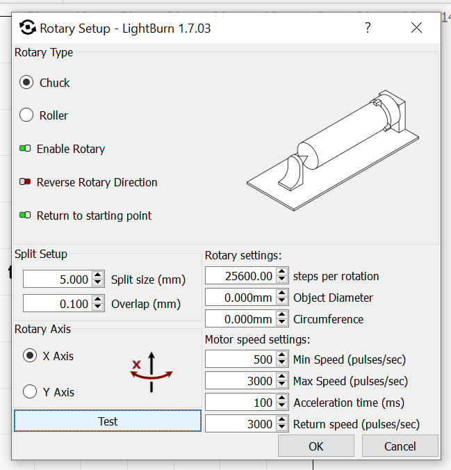

I don’t know the user base size for Lumitool but it was a nightmare getting the machine to work with their horrendous software (Both Lumitool for Windows and both Android Apps)
If you have the USB port on your machine and are willing to use Lightburn, I wanted to share my accessory settings after a bunch of manual measurements and some trial and error.
Lumitool support is abysmal and I got no help from them. I could only get the rotary tools working. Slider is a no go (I can’t even get it to work with their software).
I’ve been running the below settings with Split Setup zeroed out and it seems to work fine. You can fine tune as you please. Rotary chuck, you may have to reverse direction. Roller setting, please change the object diameter as needed. To me the scale is still a little off but it’s close enough.
Motor speed settings I basically left at default. If someone can recommend something better, please do.
Thanks and maybe this helps someone else.
