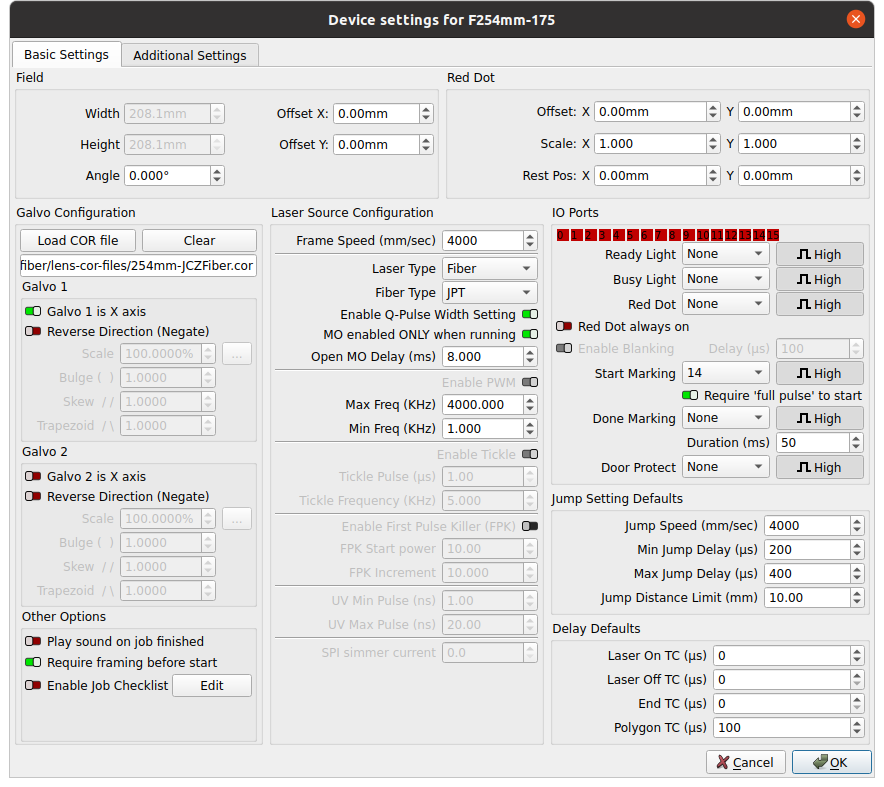

HI guys, question do you think this settings are correct for my machine?
Is ComMarker B4 with MOPA M7 60W JPT laser inside.
I want to make sure the settings on the oranges squares are correct.
Any suggestions?
Thanks
Ricky
I have the same animal…
The delay in jump settings depend on the galvo head used… some are quicker than others. Notice the difference in frame speed… mine maxes out at 4m/s
I only enable the MO (Master Oscillator) to run if it’s being used.
I zeroed out the delay defaults, had some long run times… this eliminated that, but I haven’t checked scan alignment. So I’ve been scanning in a single direction, which takes longer…
Laser Everything has a lot of good videos on their youtube presence on how to set these up…
Good luck
