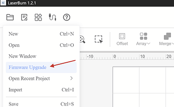

LightBurn was working three days ago, but LaserBurn app had a firmware update, I assumed it was complete, but now and ever since that my longer nano pro 12w laser will not power up. On the light burn console it say waiting for connection and port in use .ive uninstalled both softwares and reinstalled LightBurn, but still have same issue…..

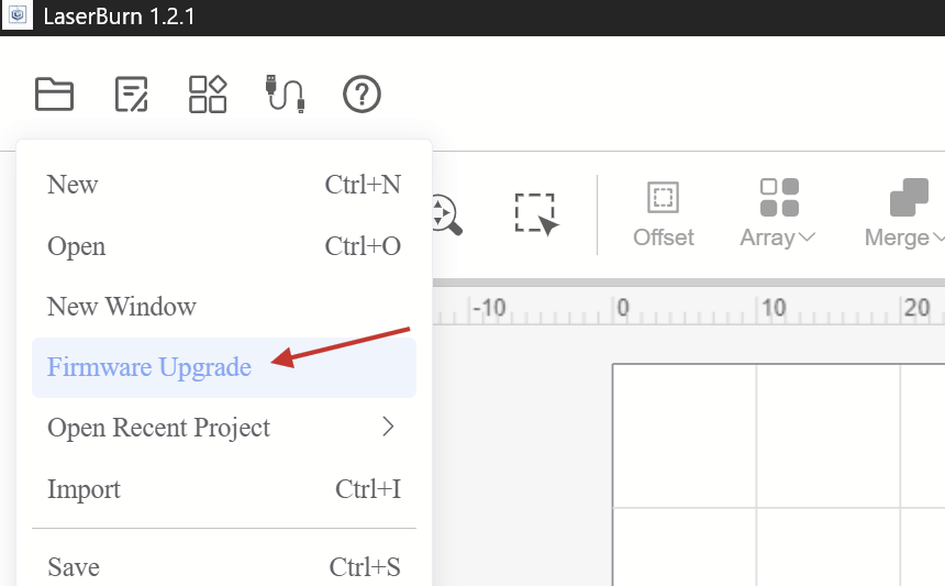

Is this the option you selected in LaserBurn?
If so, I suspect that the firmware (the program running on the laser’s microcontroller) update didn’t go smoothly and is incomplete. In that case, you should try to flash it again.

Okay, it might still mean that the button you clicked in LaserBurn attempted to upgrade the firmware of the laser. If that failed, it could be incomplete.
