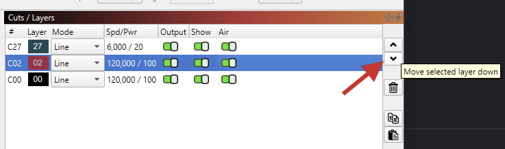

In addition to the Optimisation Settings , The order of the layers can be changed here:

Glad you brought that up. That is where I always change sequence of certain portions of image etc. It decided to quit working. Changed in Optimization Settings and it is working now.
