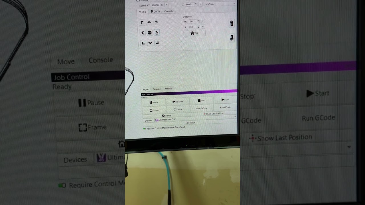

Up until now, I have only been using millage for generating G code.
I set it up for control today using ethernet but I have two questions and I’m guessing they’re issues with my settings, but I don’t see the continuous jog option and there seems to be a long delay when using the distance jog command.
If you go to Device Settings and turn on $J Jogging, this should enable continuous jogging.
Thank you very much. I was looking in the device wizard but needed to go to “CNC Tools” → “Device Settings” to change this setting.
Device Wizard:
vs Device settings:
