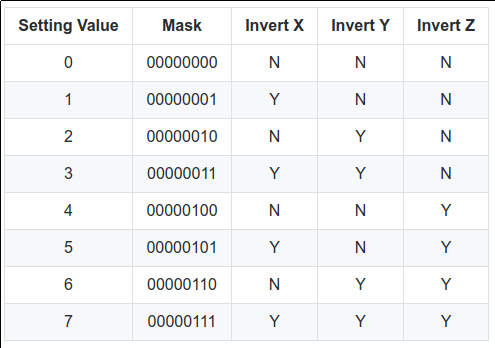

I wanted to make this a separate one. So with the question regarding the arrows relative to machine. If its meant to be looked at from the front of my machine then the y axis is backwards, when I hit down arrow the laser moves to the rear of bed, and to the front of bed when I hit up/top arrow. (if the arrows are really telling you its where the laser module is moving) but when I hit left arrow on my screen the laser (standing in front of the machine) moves to the right side. just wanted to recap on that part by itself incase my first message was to much back and forth with that part.
On my machine X- (using the jog controls) moves the head to the left (when facing the front of the machine) and X+ moves it to the right. Y- moves the head forward (i.e. the bed moves to the back, towards the limit switch) and Y+ moves the head to the back (the bed moves towards you). It took me awhile to be able to keep the jog direction straight in my head when going back and forth between CNC/3D machines and a standard laser. What worked for me was imaging that it’s the head moving, and the bed is stationary, then it makes sense. BTW, the $3 setting in GRBL lets you change the direction of the steppers if they don’t move in the direction you are expecting. Hope this helps.
ok great! so mines doing exact opposite as yours. in my grbl settings my $3 is set to 4. what number is reverse that?

ok so i actually found a video on this!! i changed it to $3=7 cause both were backwards and my machine homed!!! with the help from both you im very happy thank you Paul and Mike.I had to enable auto homing again. check it 3 times each time it worked flawless. Now that it homed. i then shut machine off turned back on and my x-3 , y-3 . so its offset in by 3mm each way. so i need to do an offset? cause if i happen to cut something out with a border of 220 in either direction would that make it actually 3 shy of 220? or is that 3 on screen just if i make a 220 frame lightburn will say im gonna go out of bounds cause 220+3 is obviously over. but in reality the actual posistion is correct on machine just says 3 in lightburn
I was going to post this chart, but it sounds like you’ve got a handle on it.
Axis inversion settings
The only thing I can think of for the offset is that, at least on my Ender 3, it homes just off the bed so that there is less of a chance of the nozzle crashing into the bed. $27 is set to 3 (i.e. 3mm pull-off distance) so I’m not sure why it’s saying -3. In the grand scheme of things, is 3mm going to be an issue? On my OLM2 Pro there is a 3mm pull off but there is room on the frame for it to still allow for the full 400mm. BTW, I have the bed size on my Ender 3 set to 235mm and haven’t had any problems. For the time being, I would leave $27=3 and see if you still get the full 220mm.
