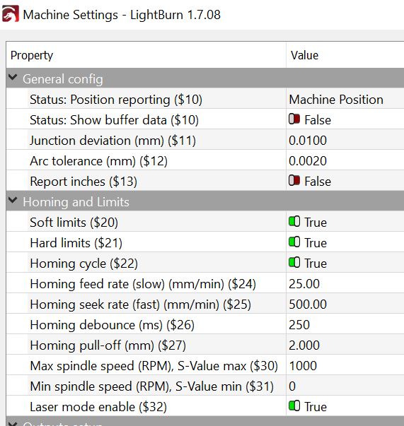

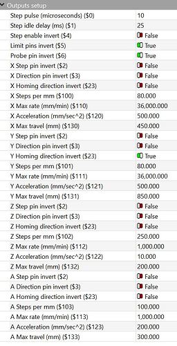

So when I connect the machine it travels to the correct corner location for homing but once it gets there it won’t complete the cycle and jackhammers there till I hit the e-stop. Attached are my current Machine settings , which hopefully I’m just missing something easy…
Appreciate any help or suggestions !!

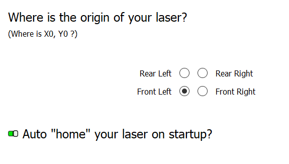

Lower Left corner

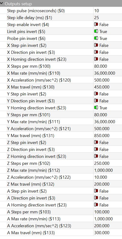

Machine is brand new out of the box , assembled with the extensions…Initially it tried homing to the back right corner so I switched setting $23 to True on the X & Y axis

When homing, if the machine stops when you manually press the Y axis homing switch then the switch is working. If your sure the Y axis homing switch is being actuated when you try to home the machine you may need to adjust the Homing Pull Off setting. Try increasing the Homing Pull Off setting slightly and see if that helps. Try changing $27 from 2.0 mm to 4.0 mm and see if that helps.
When homing the Y axis should activate the limit switch, then it should back off the switch slightly. If it doesnt back off enough to deactivate the switch you will get an error..
I have a different machine but just as a reference I looked at the settings to see what i had. I don’t see anything unusual on yours that would cause this but the Homing Pull Off $27
Mine/Yours
Homing Feed Slow $24 200/ 25
Homing Seek Fast $25 2000/ 500
Homing DeBounce $26 250/ 250
Homing Pull Off $27 4.0/ 2.0
