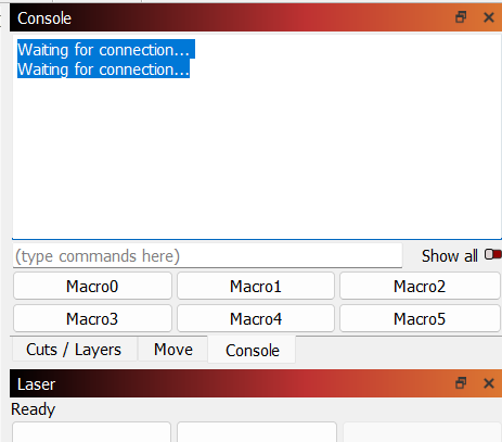

I have changed the usb cable, that is between pc and control board. I have shut down PC and laser machine severasl timea and over night. I have uninstalled Lightburn vervion 1.7.08 and reverted back to 1.7.07 which I know has worked great.
The board does seem to connect as I hear the chime when connect cable and I am able to create shapes and edit files. As stated I am not ble to move or jog the machine in any direction. Machine does not start when selected.
Anyone know any positive ideas that I can find out what to check for and why or what is not working? Is it PC problems. Is it control board problems? How do I find out what is not working.

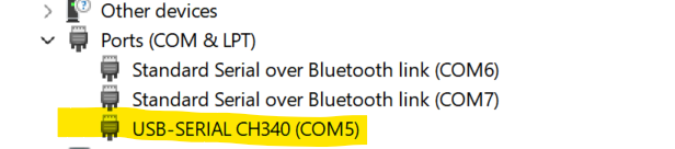

Thanks for the replies, I have checked the emergency stop, it is out. I did remove the device and re connected it. I went into device manager on seen the driver for the machine. There is only 1 com port available and it is correct. Since I am not able to see any GRBL settings when I enter the $$ in comand bar, am I able to re flash these? Or is it possible I should just purchase a new control board?
Yes, the highlighted line is what it looks like in device manager…com 3. When I connect the cable from control to Pc it does chime, I thought it was connecting.

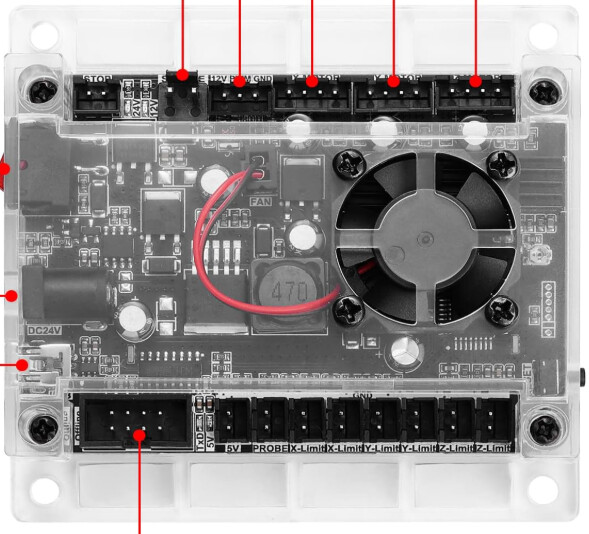

Seems it will not connect, this is why I think it is control board. If I purchase a control board what needs to bwe done? Is it plug and play, other than setting up machine?
I would say yes.
I confirmed that you have already changed the USB cable. Does the cable you connected have a ferrite core? If it doesn’t, replace it with one that does before changing the board.
the machine has been working for the last year with a cord without a ferrite cord. I did try a new cord as I thought possible the connection ends are faulty. Nothing has changed. Leaning towards a new board. Original manufacture replacement is not available. Any recemendations on a replacement board?

However, this board is available for sale without being from manufacturer.
Do a search with the image you placed at the beginning and several results will appear.
I appreciate all the suggestions and help. I did order a new ardinuio board and everything is back to working. Got machine set up and did some test burns. I do have 2 gliches that I have not experienced before…Text is engraving horizontally mirrored(upside down) and the transvers lines are engraving. How do i correct these? *EDIT…So this morning I was able to correct the mirrored and engraving the transvers lines. Had to correct the acceleration as X axis stepper was stalling.
