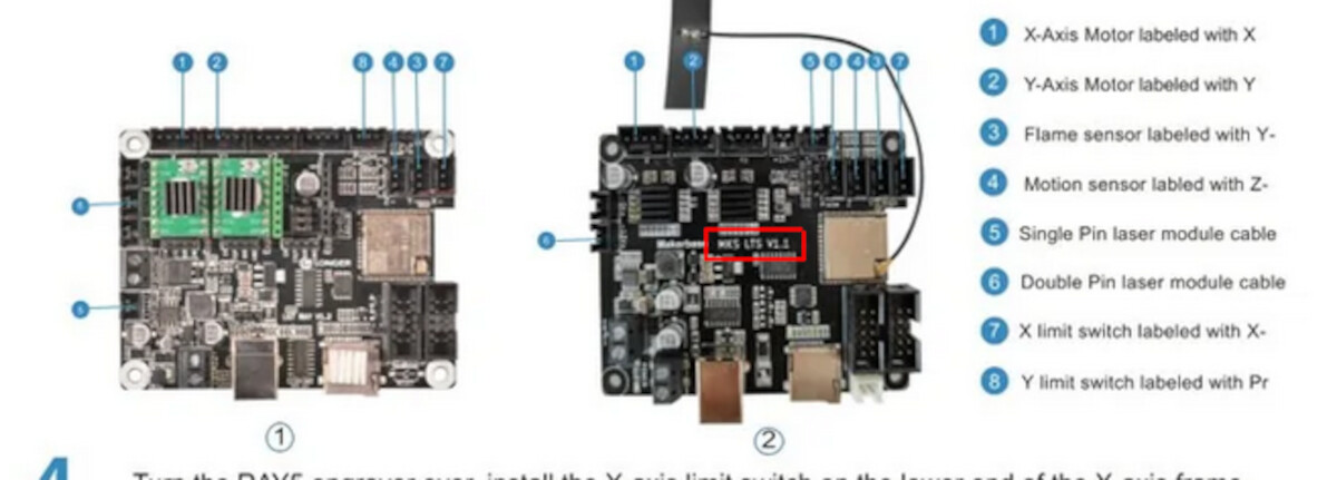

This is the link for the instructions, I can’t copy/paste the instructions because they are in an image. Ray5 Quick Install Limit Switch Instructions – LONGER

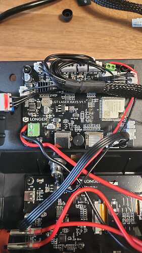

Which board is in your machine? Can you tell us what’s printed in this area?
Did you upgrade the firmware and did it complete OK?
:grinning_cat:
That’s kind of the annoying thing - neither of those exact boards is in our machine. Ours looks the MOST like the second one, but there’s still some differences which is why it took us so long to wire everything in.

This is the board we have.

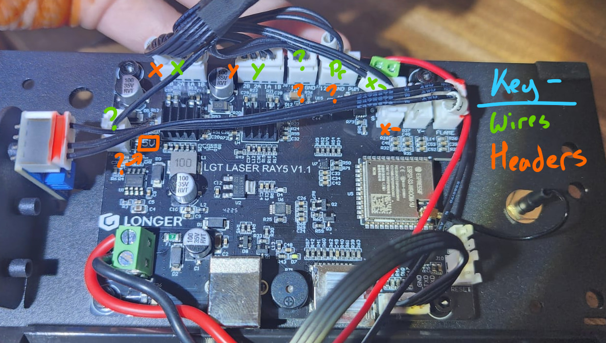

Hi @Flasheart
Do you have a multimeter?
Can you annotate your photo to show us exactly which headers you are connecting the limit switches to, please?
I took a better photo to annotate. Green are the wires, orange are the headers. 4 of the wires were labelled (X, Y, X- and pr), 2 of them weren’t.
Father can’t find his multimeter, but he can get another one reasonably quickly so he’ll have one by either today or tomorrow.
Thanks for this, but I’m none the wiser.
Since your board revision doesn’t exactly match the documentation, I’d strongly recommend confirming with Longer which header pins are intended for X- and Y- limits on the LGT LASER RAY5 V1.1 board specifically.
The behaviour you’re seeing (full power loss) suggests something electrical rather than firmware issues, so you’d want to be absolutely certain the switches are connected to signal inputs and not a power rail or are faulty.
From what I can make out, and it’s just a guess….

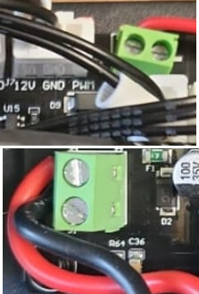

The top right green connector and the bottom left have much more heavy lines than elsewhere. I’d guess the bottom left is power in and the top right must be output to the laser.
Just left of the top red connector, the white one, it’s labeled PWM, so that’s generally the laser control.
Which is your wiring and where does it go?

In the annotated diagram, all of the marked wires are our own wiring.
@Dominic , we have sent an email to Longer and we are awaiting a response. However, we are only here in this forum because Longer support stopped responding to us when we initially had this problem, so we aren’t holding our breaths on them coming back to us.
@Dominic @jkwilborn
After speaking to longer, they sent out new wiring for us to use. When the new wiring arrived and we could immediately see what the previous problem had been - there was no Y- wire to connect to the board. Connecting the new wiring stopped the issue of the machine switching off when the Y- axis switch was pressed.
