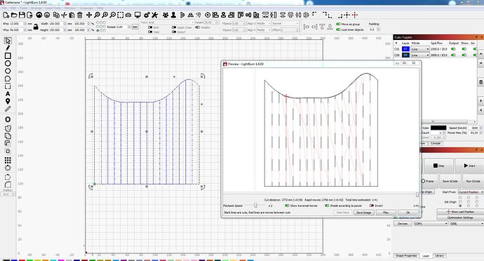

Maching lines within two images
Hello you all!
It is likely that this subject has already been clarified, but I do not know the appropriate term and I did not find what I need in the forum.
What I want is the image in green (bottom right).
The way to get there is what I think can be much easyer.
How I tried to do:
1 - Imported a DXF image and use “offset shape” tool on them resulting im the red image (Upper left)
2 - Create a rectangle with “Create Rectangle” tool, using “create array” tool create an array of the rectangle, gave it same width and height of the dxf offset result image and group it (bottom left blue image).
3 - Center both images one on top of the other and used the “boolean intersection” tool (red arrow). The result is the image on the upper right corner.
I thought this was enough.
My question is: What did i do wrong for some of the vertical lines disapear?
To obtain the green image (bottom right) I have to use “draw line” tool, create an array of that line, group them and give the same width of red image. Put both images one of top of othr and centred. Then, one by one, adjust the height to the upper line of the red image.
Question 2 - What is the specific word to what I intend to do? :grin:
Thank you for your patience.
Have a nice Sunday!!!

What I’m trying to do is draw a line on paper that will later stiked to a plate sheet to be folded into 10 equal parts. In the end it will result in a tube with a certain shape at one end to match right with another tube where it will be joined.
My idea is that the outer line is a cut and the inner lines are dashed to keep the shape together and serve as a guide for where to make the folds.
I’m having some difficulty understanding your “strategy” but we’ll get there. :sunglasses:

  1. create vertical lines and place on layer, set perforation
  2. create outline shape and place on different layer
  3. duplicate outline shape
  4. select all vertical lines and then add outline shape last to selection
  5. Tools->Cut Shapes
  6. Delete unwanted portion of cut shapes
Separately, in terms of cut order you probably want to do the perforation before the outline cut.
It was not easy but finally i identify what I was doing wrong.
I was selecting vertical shapes and then draging the mouse until outline shape, so both shapes be selected. But this is not what you intend.
What you mean is, Select vertical shapes, then with Ctrl key pressed, select the outline shape.
This way I get what I pretend.
On this example we need to duplicate the outside shape. But in the project i am doing “duplicate” was not needed and the result is precisely what I pretend.
So I think what I was looking for is “Cut Shapes” function on “Tools” menu.
And probably this is what I think I have seen before on a toturial. :+1:
Thank you very much @berainlb for the patience to find the solution.
